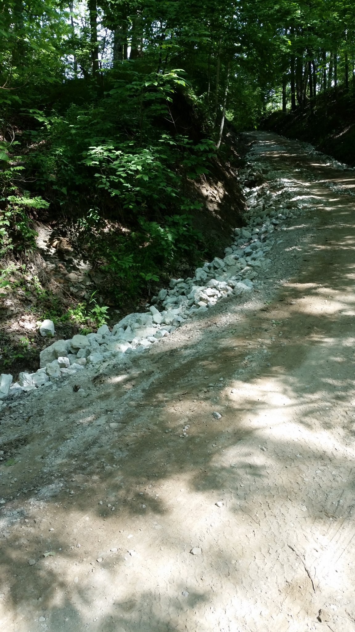

So I have a few project areas on my NH property that I need stone/rock etc. of various sizes to complete.
What I am finding is that no one refers to rock or stone by the same name so when I call a stone place and ask for rock for a drainage ditch in the 2-4" range they for some reason think I am talking about crusher stone and that I don't know what I am talking about.
I have crusher stone for my "tractor road" that I need more of, and I use that to firm up some areas of my 500' driveway but for the drainage projects I need a few loads of that heavy 2-4" stuff that will prevent erosion while allowing water to drain efficiently through my culverts.
What the heck should I be asking for?

"Washed rock" of whatever size you need. It will have no dust in it so it won't settle and pack in when wet.

What he said, gravel for roads for example would be described as 3/4 down or 1/4 down, the down describing the pulverized dust in it still. You're after the rock without, described as clean.

3/4" stone is exactly that, only 3/4 inch stones nothing else really. Its best for drainage situations and its more expensive because its more refined.
3/4" gravel has 3/4" stone PLUS fines which are smaller sized stones and dust etc. This helps it compact better. Its used for driveways.
Im putting in a driveway extension in a wettish area. I bought 3/4" stone to make some french drains and i bought some 4" gravel to make a driveway base. Ill top the 4" gravel with some 3/4" gravel so the big rocks dont slice my tires.

Rip Rap here. Visit local quarry learn what they call their products.

Here, your stone specification would be called "Number 3's" or #3
The other stone listed by others above would be locally known as:
2A modified = crusher run, paver base
2B clean = 3/4" clean washed (drainage stone)
1B clean = 1/2" fine clean washed (drainage stone)
as stated above, check with quarries as to what identifications they are using...another source would be your state highway construction division or any landscape supply place.

In NH it will be called rip-rap or erosion control stone. A 6" minus.
Some people will call crushed stone gravel up here for some reason.
In NH you will find "bank run gravel" with various max stone size. It will be right out of the bank and generally speaking the stone will be round.
Then there is processed gravel where you get the crushing with the stone. This will be offered in another max stone size. Generally speaking processed will have sharp edge stone.
