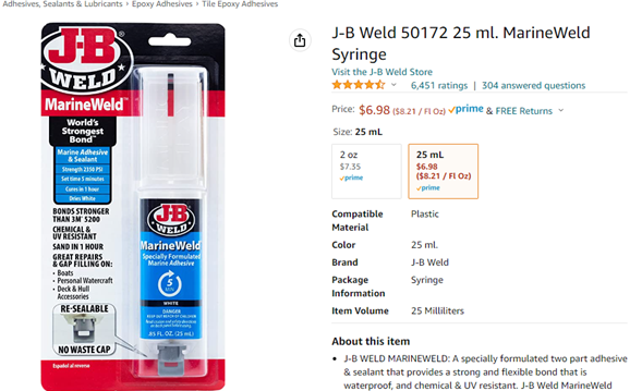

Another product which might work well is Marine-Tex… designed to repair holes in boat hulls. Worked good for me.
Elliott in GA
Mar 10, 2021
629
609
North Georgia
Although I like the suggested JB Marine Weld better, JB Water Weld works very well on just about any surface, and you usually find it at every big box or WalMart store. It cures faster, and it would be a good product to have on hand for a quick repair in the future.
