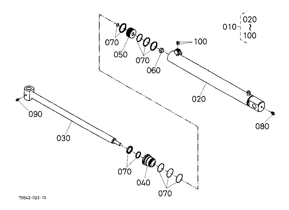

Hello, I have a L2550 with a LA 450 front end loader. Recently, one of the boom lift cylinders is dripping hydraulic oil quit a bit, A few drops wouldn't concern me, but this is getting worse. I've never pulled a cylinder apart to replace seals before. I found a parts diagram, one type of seal is shown in several places. How difficult is it to pull one apart and change seals?

Thanks. I can see it takes a spanner to pull the "head" as they call it off, but there are seals shown on both ends of the head and piston, shown as part 070. The description says "kit seal". Do they come as a kit?

All the seals needed to reseal the cylinder "should" come in the kit. It is a much easier job if you have a pin spanner and a seal install tool. Both are available online for a reasonable price. I like to have a ring compressor to compress the piston seals and help with installation as well.
If you look at the parts picture that you posted, all 10 items that are labeled as "070" is included in the seal kit.

Thanks for the info from all. Never thought a cylinder rod would bend under normal use. One issue I have is, looking at the parts diagrams, there are 3 different diagrams, appears to be of different serial numbers. Two of the diagrams use the same part number for the seals, but one has a different part number. I cannot make out the serial number on the sticker. The LA 450 is bright and clear but right below the serial number is missing. It's not a stamped metal plate, but a stick on. I'm not sure how to determine which seals to get. I assume if I order the parts I'm stuck with them if wrong. Maybe the local dealer can shed more info on this.

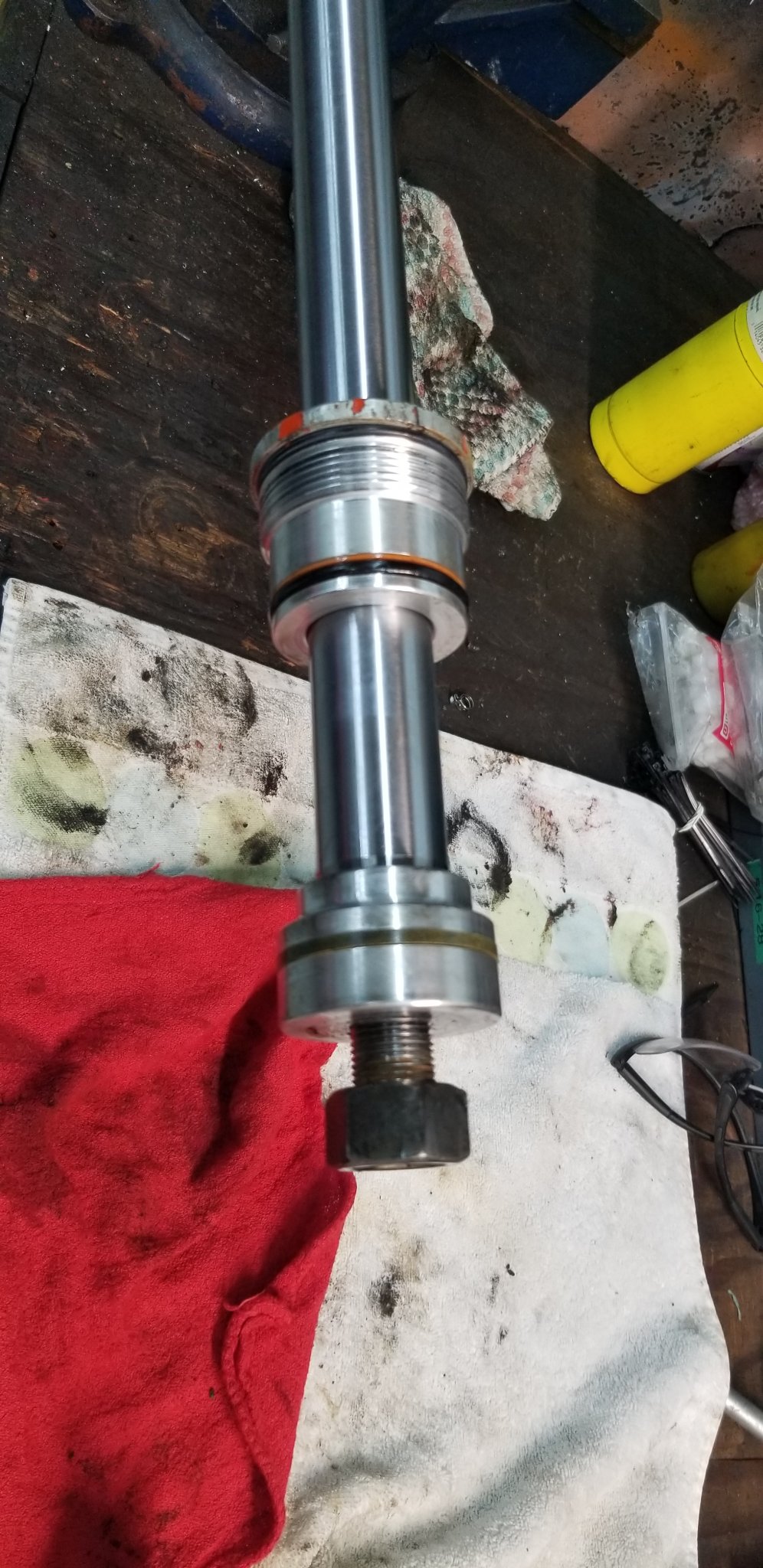

It's been a while since I posted my question. Had to delay the repair but the leak got so bad it forced it.
I ordered the seal kit from my local dealer, one was in stock at a different branch and it was in my hands in two days.
Went at it this morning. The pic above is just about exactly what I found, only mine had a self locking nut. All the old seals were dry rotted, they just broke apart licking them out. Didn't take long to replace the seals/o-rings. I coated the new seals with synthetic grease and it all went together easily. Back running and no leaks!
