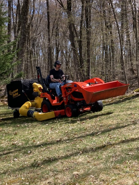

If you want to vacuum your lawn as if you had a Dyson, take a look at the Cyclone Rake.
Shortcomings are:
  • Price.
  • Turning: It mounts to the 3-point hitch and the wheels swivel, so it's like driving a fork-truck, but being seated toward the front rather than the rear.
  • Backing up: You aim your tractor and have faith the trailer will catch up, which it will, and then it'll over-correct, and re-correct, and.... Basically aim your tractor and don't worry what the thing does, it'll wander around like a drunk but always wind up heading the right general direction.
  • Holes: The wheels are sturdy, but you have to not catch them in potholes, especially backing up.
For all of the above you basically want to remember slow is smooth, smooth is fast.
It's designed incredibly well and everything "just works" and is "really convenient." On my unit the float bowl and fuel tank has been drained before storage and refilled with fresh fuel before use, and so far has always started with one pull--one. It has electric start and there's no need to use it--that's an example of what I mean by "really convenient." The trailer tilts too, so when it's full undo the back, tilt it up, drive forward a bit, close it back up, go back to sucking.
If you can accept the shortcomings it sucks up everything, sticks, dog poop, the neighbor's cat--no wait, that didn't actually happen. You do have to be careful of sticks in the flex tube when disconnecting the unit though.
The thing sucks--really sucks, and that's why people buy them.
(mounted on a Kubota BX2370)
