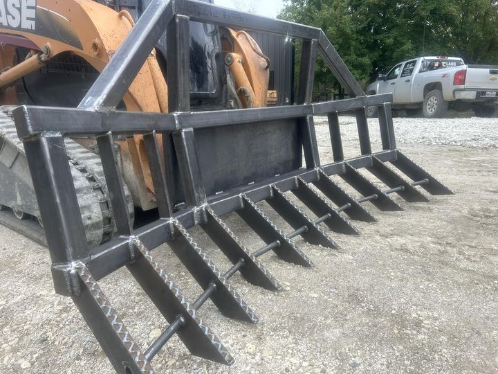

Subsoiler. thanks now I got some ideas.
It’s going to have to have much better teeth than this though. But yeah I can see how this might work, I already have stumps dug out. I can just back drag the bucket on float to finish after I pass a few times with something like that.

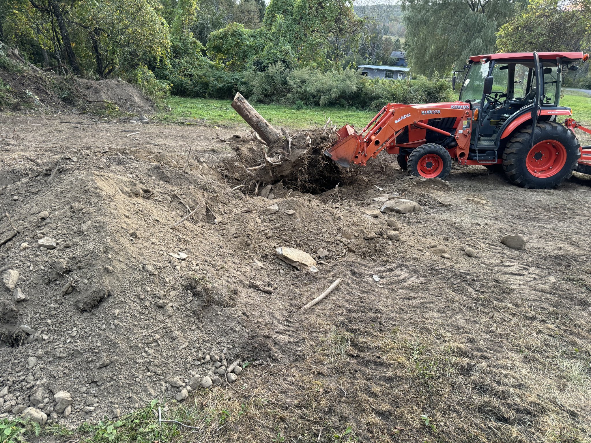

Its cleared. I have tons of ”pot” holes left from digging up big blue stone rocks and out crops, clearing trees and stumps. I have backfilled and floated But it’s still a bouncy ride. This is the finish work to fill in and level off so I’m not bouncing around. Tons of rock and lots of those wild grape vine roots. Man I hate those %@#@%%&%$

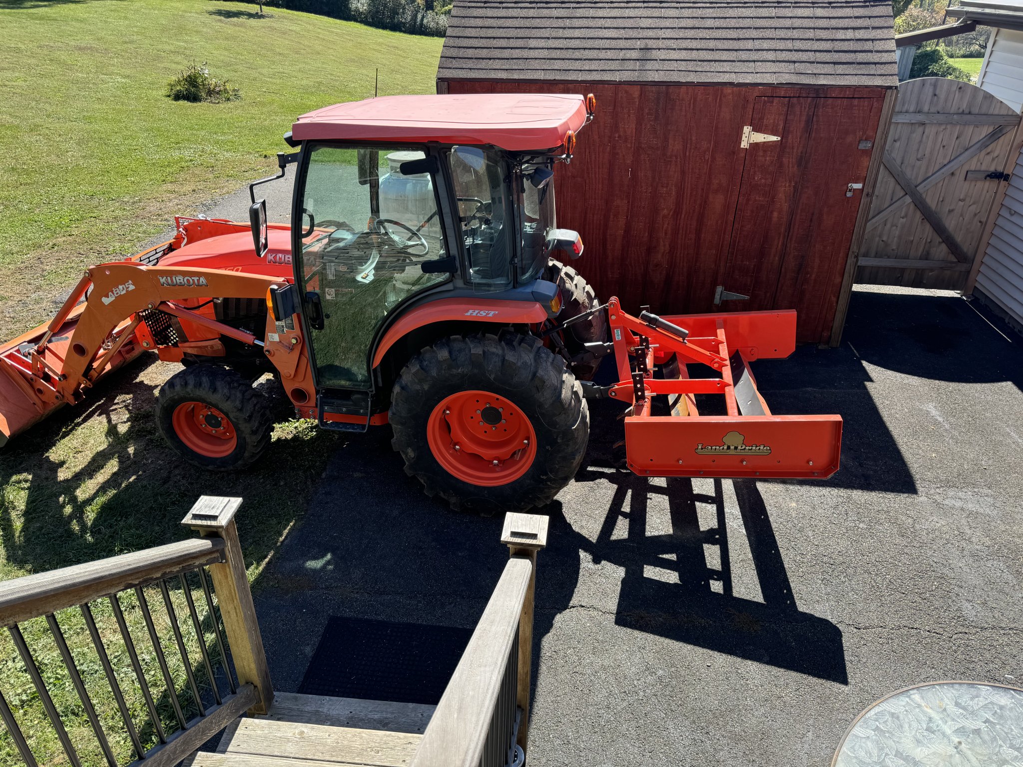

picked up a land pride gs1560 today. 1750 had a small dent doesn’t effect use. Just ran a few passes with scarifiers just a hair below blades. So far so good. Only one root stoped me dead. Also acting like take and cleaning up stuff and have a nice dump area in the passes. Also picked up a heavy steel fence post. Man I took so much crap out of the rock walls and other areas. Knock on wood no flats. But scares the hell out of me. Hate the way people would use their own property as a dump.
Worked well on trails too. Just going to keep going over and over it.
Going set the scarifiers down one more setting and work on the area that is just dirt and rocks to see how it’s fairs filling in holes and leveling(smoothing) things out. I appreciate everyones input very helpful.
I opted for the 5’ and not 6 as I didn’t care if it covered rear wheel tract wanted to have more power to operate. It’s only just a few inches on either side anyways.k
Setting scarifiers down really is working now. But found that pile of buried steel fence posts. low and slow because you can run into stuff and don’t stop quick can turn into nightmare. But man what a difference now.

So wanted to share my update with some pics to close this out and also to thank everyone for their suggestions. Some before pics:
