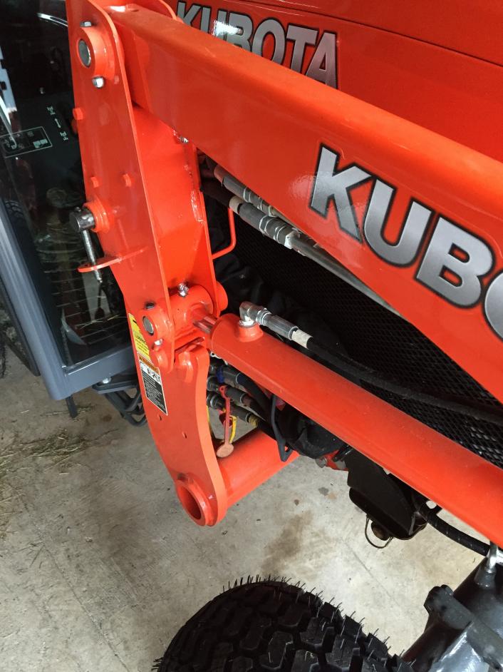

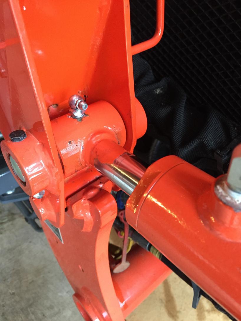

Hit my first 10 hour mark for greasing. On the FEL there's one spot that's dry as a bone. Grease won't go in, just comes out at the zerk. I removed the zerk and its flowing fine. I checked inside the cavity and cleaned it out, there seems to be no obstruction, still no luck. I'm assuming to remove the sliver pin, but don't know what position I should put the FEL in to take the pressure off. Lay it on the floor? Disconnect it?

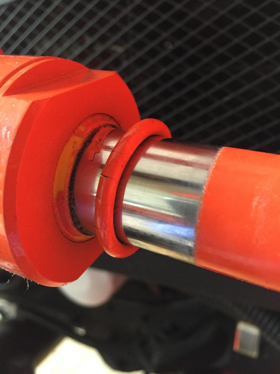

Also on the same spot, It appears to be missing an o ring. The other side has one. How can I replace such a thing?
Any advice appreciated!

If you need to remove the pin, I would put a jack under the bucket, turn the engine off, wiggle the joystick to release pressure. This will allow you to move the bucket up or let it down to get all pressure off the loader arm. This should allow the pin to be punched out.
I think the O-ring was there to protect the seals while painting. It has no other purpose there.

For that pin just lower the bucket to the ground, turn the tractor off and move the control lever around to relieve all the pressure on the lines, then try greasing it again, if still nothing then remove the pin. ;)

The first two posts have you covered. If the pin won't drive out fairly easy, you still have pressure on it. You could also remove the FEL and then pull the pin if you would rather.
You are not 'short' an o-ring. You actually have an extra! As already mentioned, once the paint was applied, its' job of protecting the face of the seal was done. If you cut that o-ring off, both sides will match! ;)

I had the bucket to the ground and wiggled the control stick around to relieve the pressure when I tried greasing it up unsuccessfully.
Since I have the quick release for the bucket, maybe I should just drop it to get rid of the weight off the loader arm? I'll give that a shot and if that doesn't work I'll go the jack method.

That won't really help you, just drop it on the ground (no weight on the arms) and then hit the pin with a hammer a few times to loosen it up.
