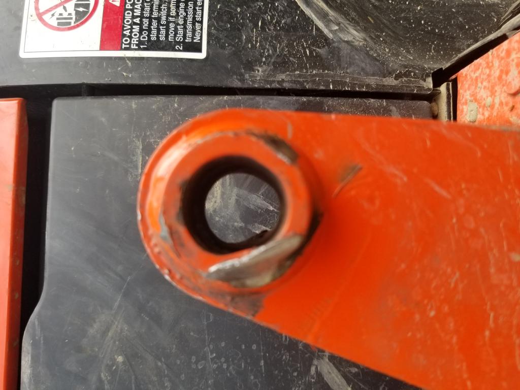

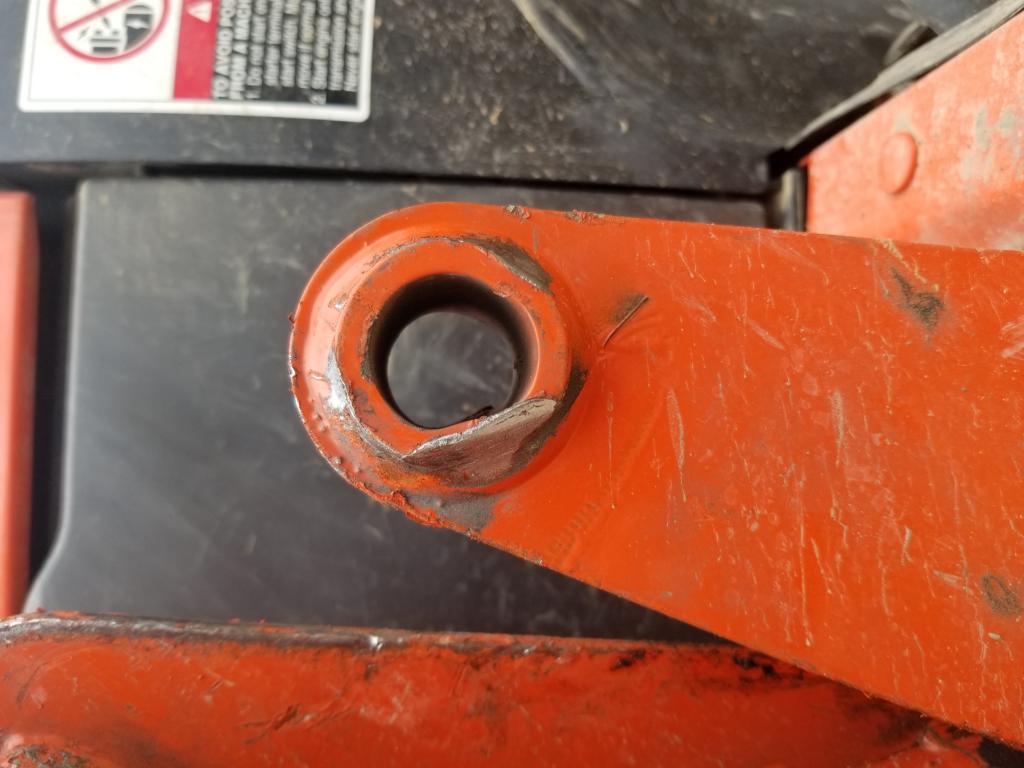

I have a 2019 B2601 with LA435 loader, at under 200 hrs. loader arm would occasionally disconnect from the loader quick connect frame. this is the reply from kubota.

changed all fluids and filters 2 times 50 and 200 hrs. grease all fittings 3-4times a week depending on use. the part with wear does not have a grease fitting. looks like a bad design!

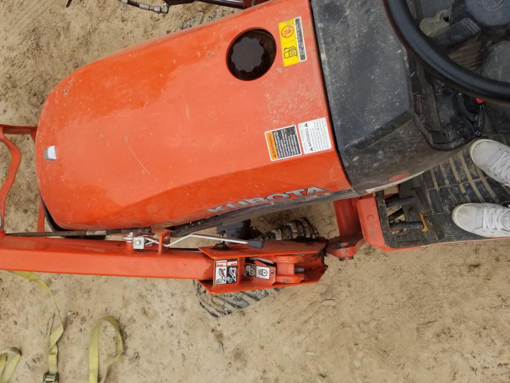

LA435 on the 2019 has a quick connect feature only had the loader off 2 times 1 to take pictures to send to dealer and 2nd time at the dealer. so they could take more pictures. It looks like a piece of pipe approx 1 " long on each side welded to the loader arm that fits inside a locking collar there is no grease fitting and does not show any lubricating point on the owners manual. Have moved approx. 100 10 yrd dump truck loads and dug up approx 6 tree stumps so far. approx. 220 hrs on tractor so far. No problems with mower so far.

There are no grease fittings on that pin because there is supposed to be zero movement at that joint. From the pictures you show of the wear on the mount, something obviously went wrong, there’s too much movement at that joint. Looks like quite a bit of metal on metal movement. I suspect the loader wasn’t mounted correctly or something is out of spec and the loader mount isn’t matching up with the loader arms. There shouldn’t be any wear at that point at all.
The side that is worn looks like your back blading a lot?

Both sides are worn about the same. most of the time was moving dirt and tree limbs, brush and firewood. approx 50 hrs digging with backhoe. have not noticed any way to adjust movement of the arm. Any ideas would be appreciated Thanks

From your picture it looks like you have the wrong size pins in the holes. Either look up and get original pins from a dealer for it or measure the holes and see what size is closest to the size you measure.

What pins? Are you perhaps seeing THRU the hole and the background steel appears to be a pin?
