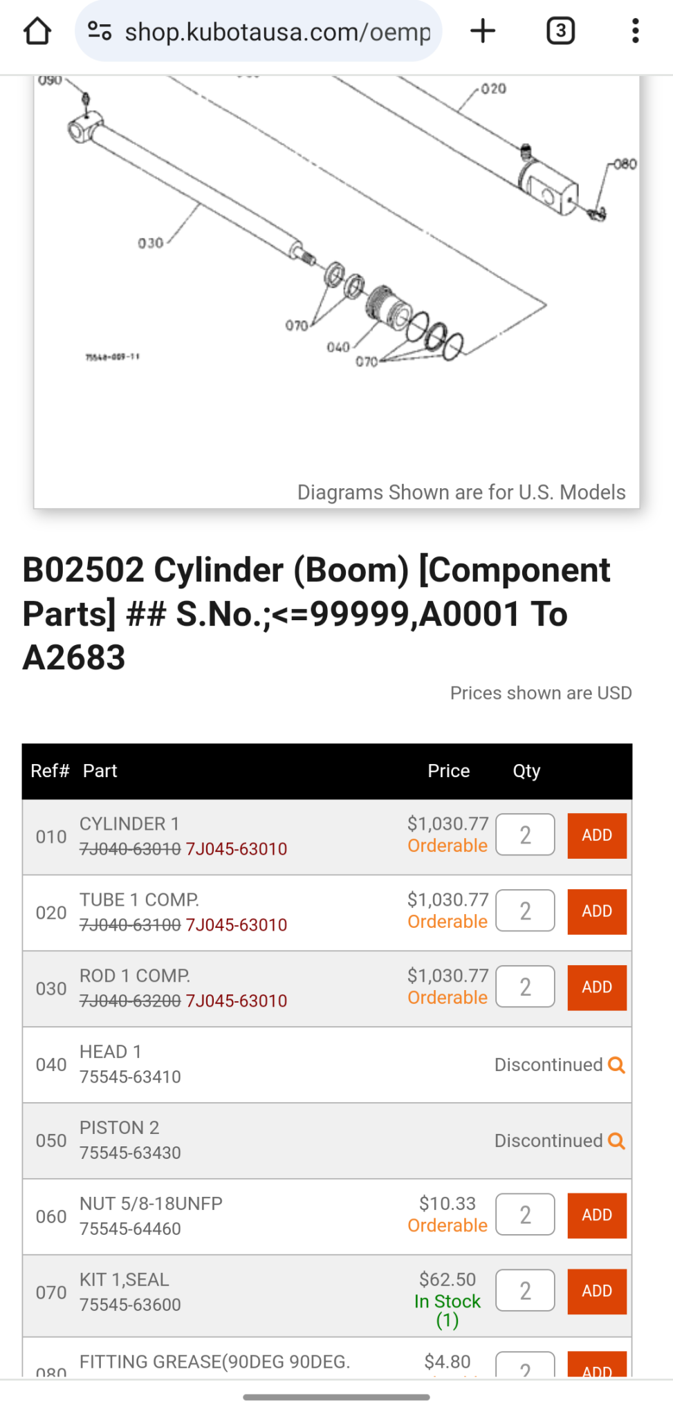

I have found an issue in trying to find the seal kit for my bucket boom.
Kubota LA402
SN 17102
Cylinder 7J040-63011 OH-058J
I keep getting listings for SN A2684 and after. Where do you get seals for an earlier SN number.
Thank you, Kevin

According to the Kubota USA site, the kit you need is 75545-63600. Confirm with your dealer.

I checked their listing and it will not work for my tractor. I bought the same one they show. There was a change in the cylinders at a certain serial number and I can not locate the parts needed.
