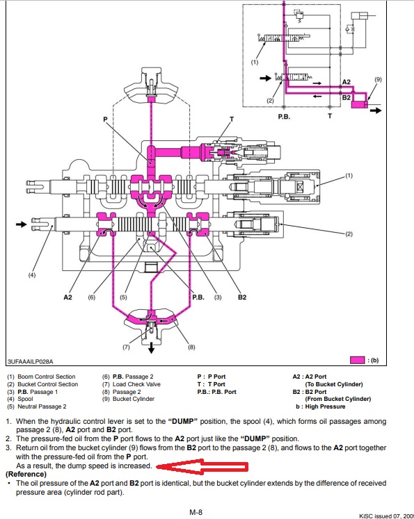

I looked at the WSM for the LA1153 loader and its valve.
It seems to me the valve is always operating n the quick dump mode unlike smaller tractors with small pumps.
I have not studied this and my impression may be incorrect.
Dave
It seems pretty clear from the bucket spool cutaway that there is no fourth position.
