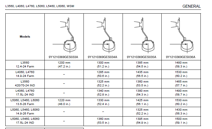

Have an l6060 and use it up in the Highlands NC area, I want it to have a wider footprint for stability on the land we have, some steeper hills and uneven areas, I want to feel more stable when working. 3 inch or 6in?? is a 6 too big?

Do have the FEL, 6 ft. Tractor is roughly 66 inches. I'll be 3 inches wider each side going full 6" spacers. maybe ill go 4" spacers. Thanks for the quick reply.

Have your wheels in the widest config? You probably just need ballast…

don't know if I do have them in widest configuration, new to this. I have the l6060 grand.
The inner wheel disk relative to the outer rim can be placed in several positions. You need to identify if you have liquid in the tires as well. The owners manual gives spec as to what the widest position for your machine. The wheels are very heavy and you must have the appropriate tools to work on it. From the picture you post, they can be moved further out. Those are the r4 tires. I suggest placing those in the second from widest spot. Then have the tires filled with ballast or add wheel weights.

You don't need spacers you just need to set the rims up properly to make them wider.

My tractor rears are set to the widest configuration. About 1/2 of the rear tires stick out past the rear fender. This may help you visulise the spacing, dealer took right rear and mounted on left side and did the same with the left rear to right side. Tires measure 72" width overall, outside edge to outside edge.
