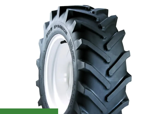

R14's would be a option also. Plus being a radial he could air them down a long way for better flotation/traction.
I have seem them at dealers on the L6060's and the MX6000's

R14's are much more aggresive than the R4's and you could mount them on the same rims, so cheaper to do.
Turf's would require new rims.
and traction would be much lower than R14's, but flotation might be better.
If you tell me what size tires are on it now I can tell you the R14 sizes to use.

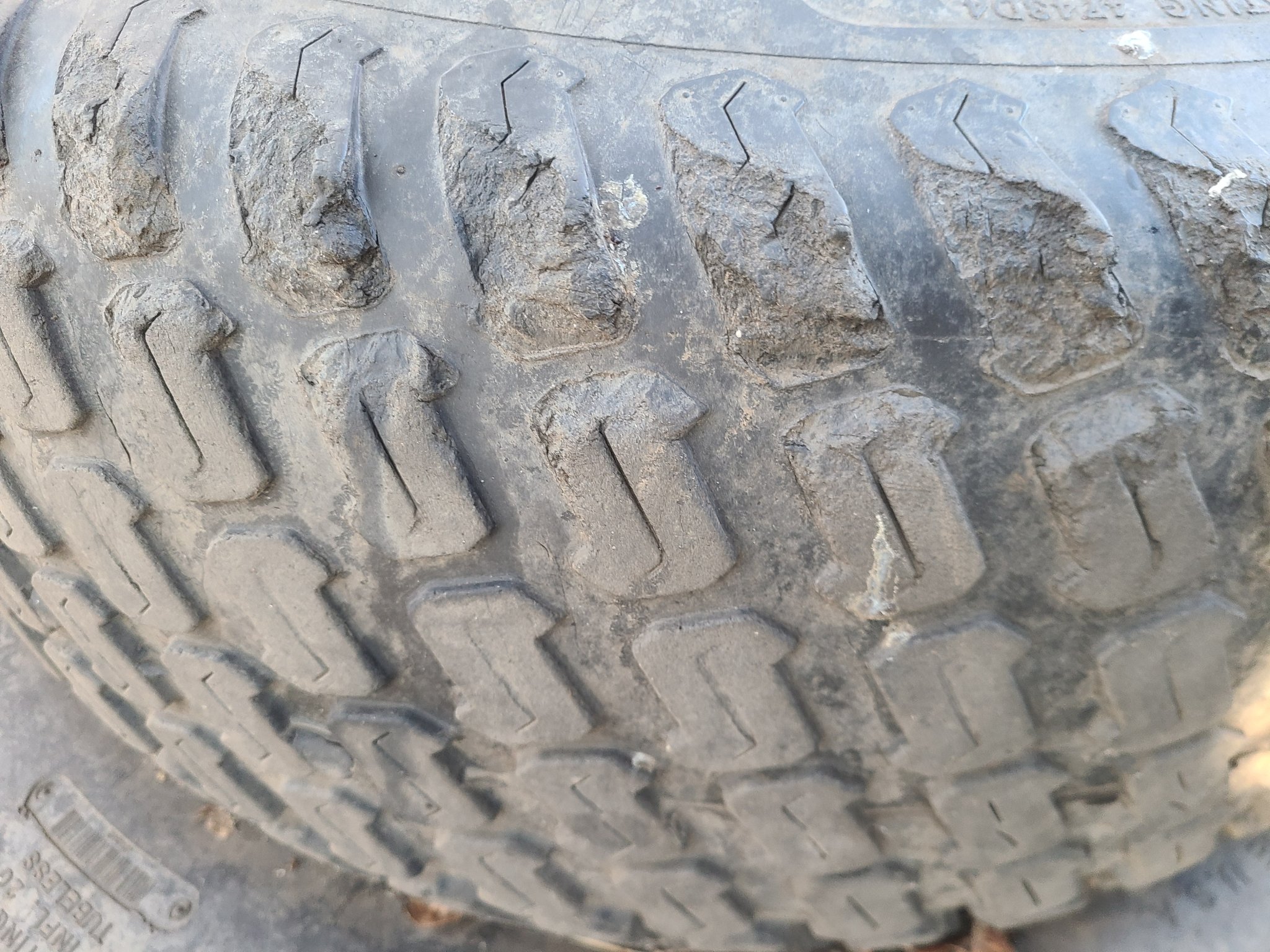

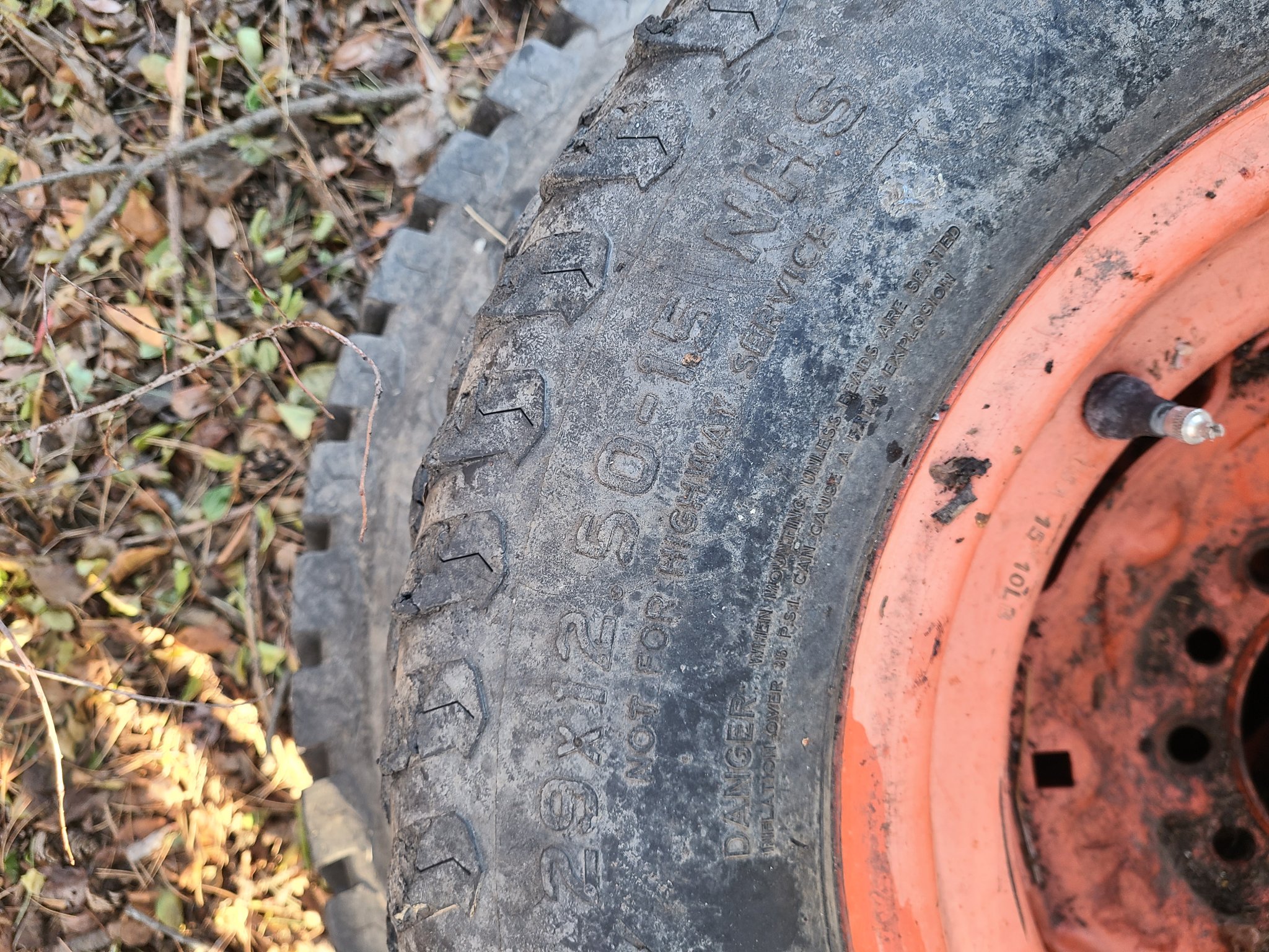

KJ - I had a deal fall through on a L6060 and had already bought up a set of used turfs/rims beforehand. Not in perfect shape (note: fronts have outer tread wear), but I'd let them go cheap if you're interested. Northern IL/west of Chicago.
Edit: 29x12.50-15 R3 Titan Multi Trac
44x18-20 R3 Titan Multi Trac
