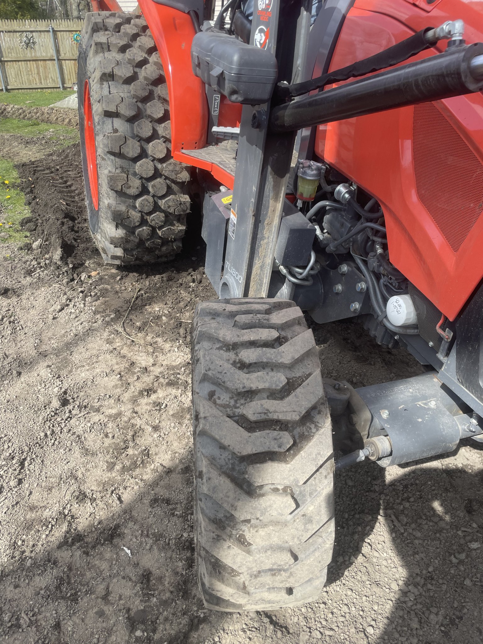

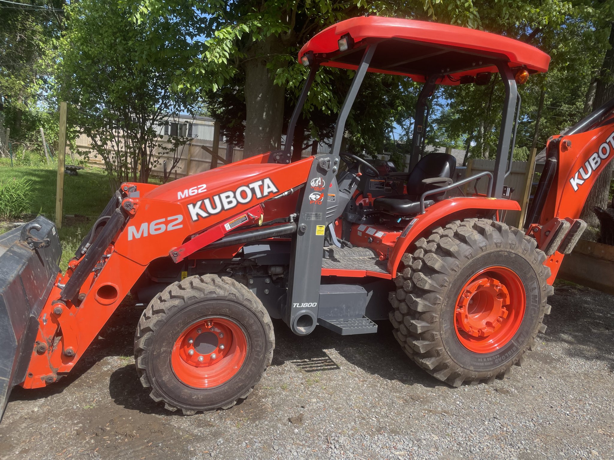

Hi I’m brand new to the site and I do realize this is an old thread but I wanted to share my experience
I changed the front tires on my m 62 to 12-16.5 from 10-16.5
(8.25 rims to 9.75 as well)
And the rears from 17.5l-24 to 16.9-24 to maintain proper gear ratio
Fantastic upgrade in multiple ways !

From factory Titan industrial to
Michelin radial bibsteel all terrain skid steer front
Michelin radial bibload in rear

M62, those are some awesome tires? Use myM59 on the farm so like the aggressive tread.
For the front switched to these switch gave better traction particularly in loader operations.
Carlisle Ultra Guard Industrial Tire -10-16.5 https://a.co/d/gq7c8hx

I wanted wider fronts I would leave ruts crossing lawns with a full front bucket
The traction advantages of radial vs bias is something that needs to be experienced to fully appreciate
