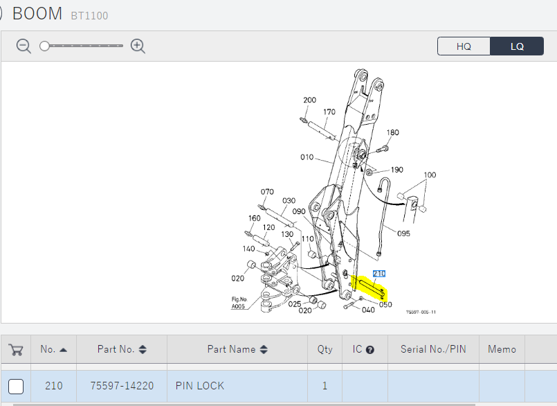

Simple answer, install the lock. ;)
That what it's designed for!
That is really not a very "simple" answer.
I was digging a long shallow ( 8") hole with the loader yesterday.
When the loader bucket was full, I then travelled 600', to a point where I then also needed the BH.
Fill loader bucket, pin backhoe, travel 600', unpin backhoe, use backhoe, repin backhoe, go back to beginning?
I only needed to raise hoe every third, or 4th trip, but still would be a PITA to pin every 4 trips.
VERY inconvenient

Not just inconvenient - the machine is broke.
The pin is for extended storage or long distance transport. The cylinder and valve are expected to hold during short distance transport operations. If they dont one or both is defective.

You have to get off the machine to insert a boom locking pin? That's sucky considering to price of the machine...
I really don't think the boom lock pin was intended for short distance (a few hundred feet) travel use,...... but perhaps I am wrong.
