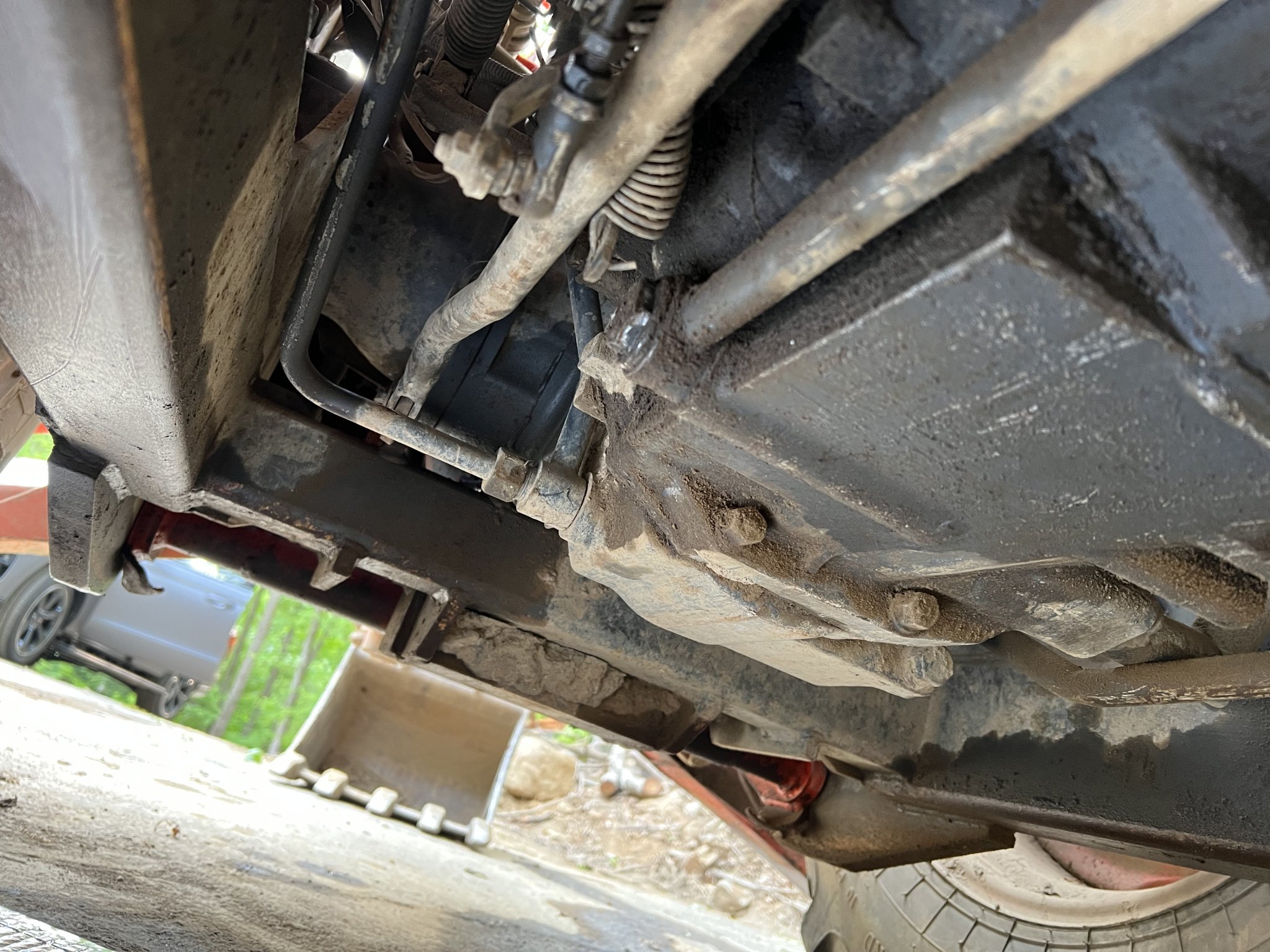

Regarding the suction filter. I wanted to confirm this is the one we are all talking about.
Ignore the wet bottom…

Looks like the L48 has two suction side filters, dual filter housing. These get changed? These filters are often referred to as screens for their high micron rating.
There is also HST polishing filter.
On the suction side there are a number of external large metal tubing joined together with pieces of rubber hose and O-ring connections. All subjected to possible damage underneath. Air being sucked in can cause hydraulic many problems. Excessive foaming of hydraulic fluids particularly at operating temperature a symptom. The B26 has a rubber elbow on the suction side line prone to cracks.

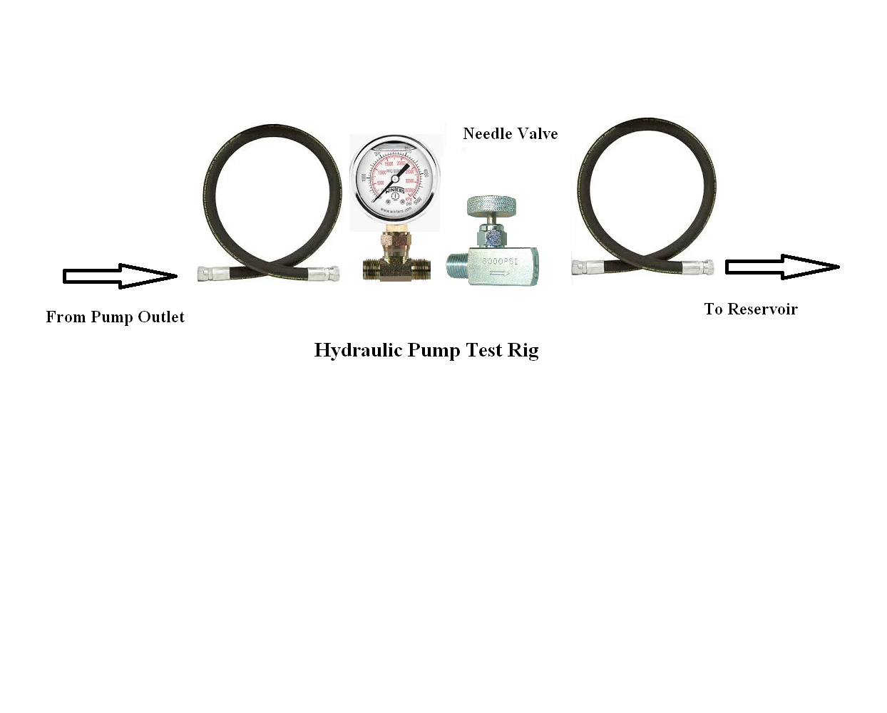

The suction side plumbing is shared by three pumps and only one is exhibiting problems. That should make one suspicious - it certainly informs my thinking. So if it comes to it how does one go about isolating and testing the pump itself?
  1. Connect test rig directly to pump outlet pipe and as close to pump as possible. There shoud be no relief valves or flow dividers between pump and test rig.
  2. Fully open needle valve and put end of reservoir hose in reservoir filler opening.
  3. Start tractor, set engine to 1500 - 2000 RPM, and observe flow.
  4. If flow is solid slowly begin to close needle valve and observe pressure.
  5. Pressure should rise to 2000 PSI with valve only partially closed.
If you can't get steady flow and/or the pressure up to 2000 PSI with the valve partially open the pump is defective.

Yes both of these suction side filters were replaced. I probably have to remove the seat and the floor to really get access to the top of those lines as see if they are cracked.
Ok, I’ll order needle valve, some hose and the T.
Look for puddles, or drips of hyd. fluid under tractor, to check if hoses are "cracked"
