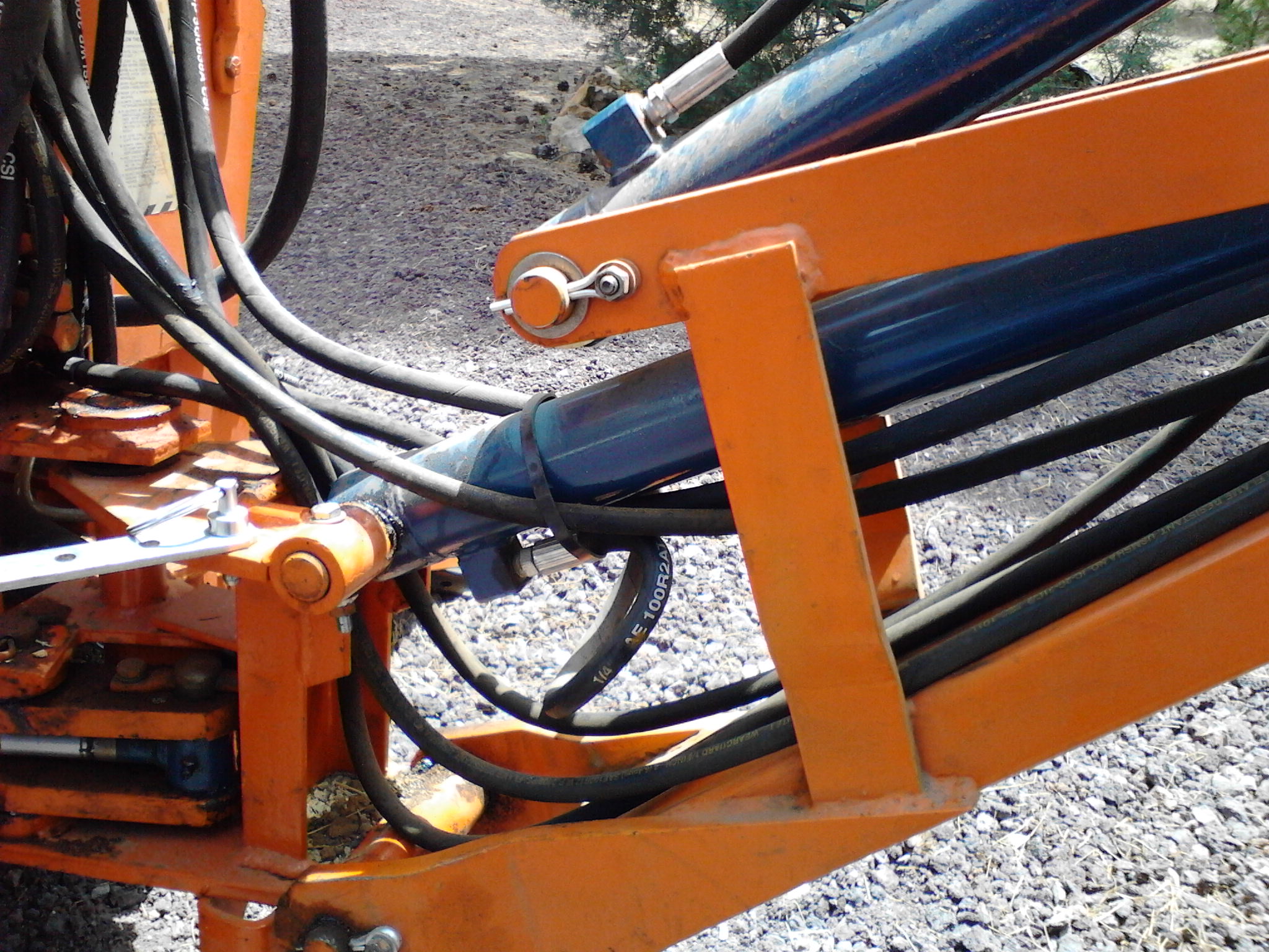

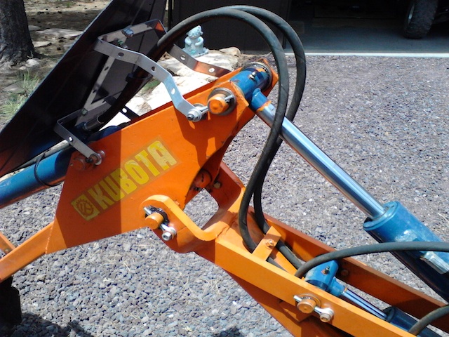

I have a B7100 with loader and backhoe that I have been rebuilding.
The bachoe has a Kubota sticker on it but my dealer says that it is not a Kubota backhoe, and they never made a model to fit my B7100.
It is labeled KUW200 or B670 I have figured out that it was made by Arps.
Anyway, the bushings that I have needed so far I have been able to buy from McMaster Carr at a resonable price, just press the old ones out and the new ones in, and they work just fine.
kubotasam
Apr 26, 2010
1,200
125
Alfred Maine
Your dealer is wrong. It may have been built by another company but was sold as a Kubota. You can see the parts list on the official Kubota parts web site.
