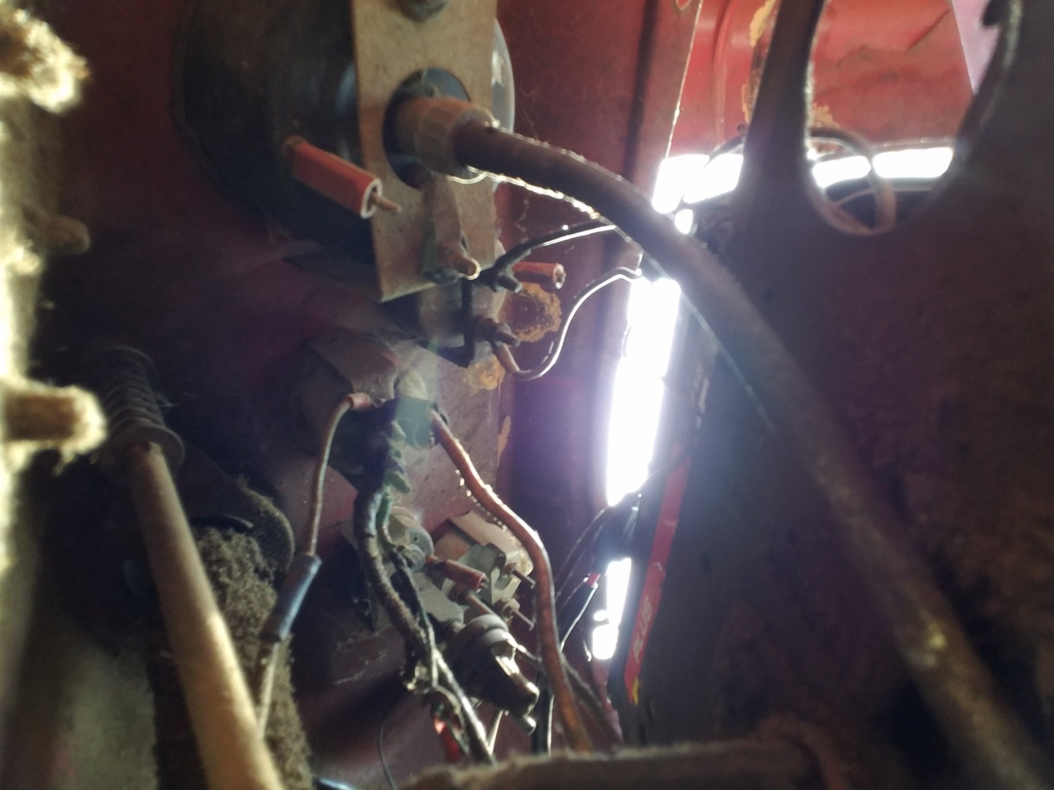

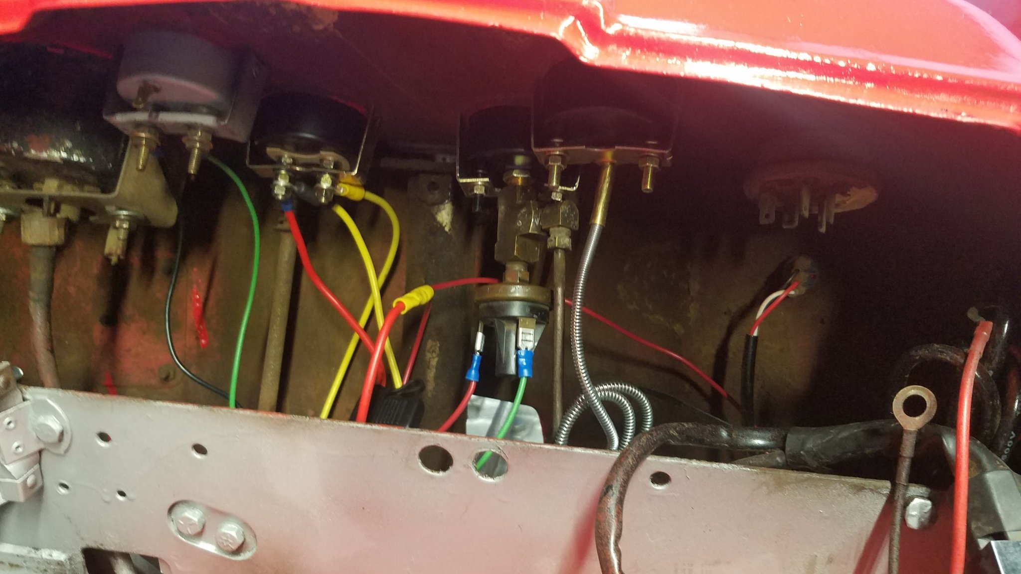

When I said dad was shorting the starter solenoid it's on a different tractor (massey furguson) and before I did some restoration on it that was the way he started it for several years, one of the reasons that I redone all the wiring and replaced all the guages so he wouldn't have to keep shorting it to start it. the push button starter switch I installed quit working and he was to impatient to wait for me to replace it I added a picture of the massey before and after of the wiring so you can see how bad it was and why I wanted to rewire it

Sorry Kris, I get to worrying on these newer tractors if you or someone else starts to blow fuses that the ECM will be damaged. Your work on the Massey looks real nice. As I suggested before, go back and check the easy stuff first, it just might be a bad contact with the pto switch. If not start with the battery and then the ground cable.
