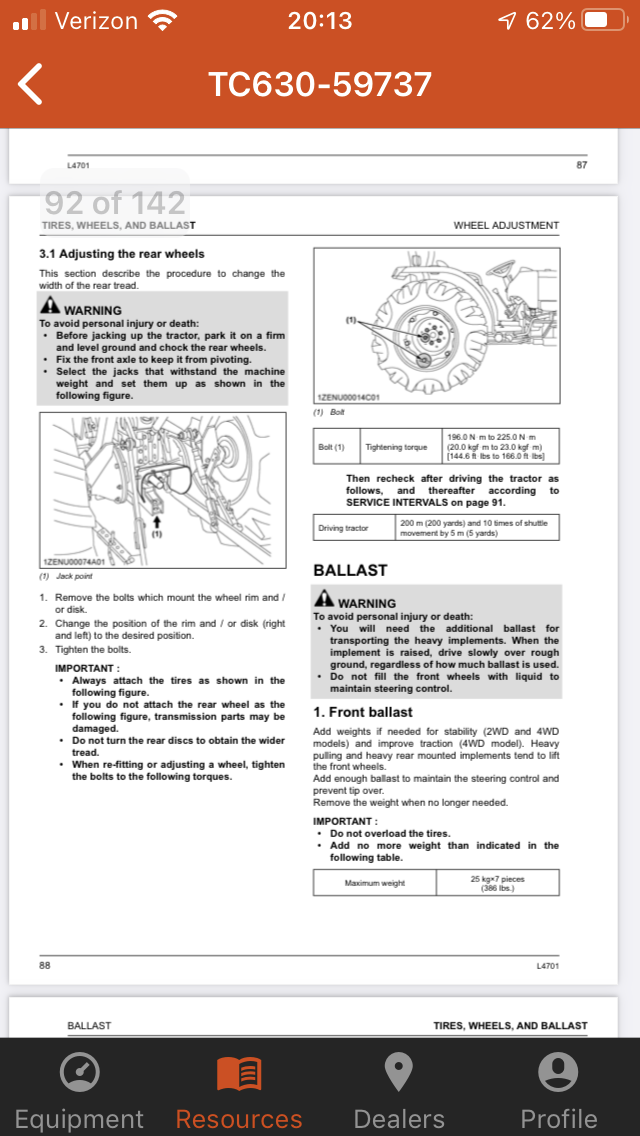

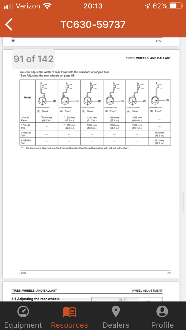

Rear wheels on my L4701 were left narrow due to a couple of clearance issues on our property. Dealer made it quite clear (and manual seems to agree) they are adjustable on the 4701 even with the R4’s. Those clearance issues have been addressed so I’m thinking about adjusting them out. Running the 17.5 -24 R4’s loaded. My brother has a 1500lb capacity wheel dolly mostly to deal with tractor and large truck tires that I can use to handle them. I’m aware they are probably around 700 to 800lb each loaded so I wouldn’t even think about doing this without the dolly. The rims clamp on the center and the manual makes it look like you just support the back of the tractor, remove the clamps, slide them out where you want them, and reinstall the clamps. I may be overthinking it but that just seems too easy. Only two pages in the manual that mention it should be below (or above). Am I missing something or is it really that simple?

Yes, if you can handle the weight of the tires it's really that simple. If you look at the tractor and wheel it should be intuitive how to make it happen.

Depending on how your rim / center disc is set up now, and depending on what width you want to achieve, you might have to pull both wheels off at the same time to keep your tire orientation correct.
There are no clamps.
The center disc is dished and is reversible. The outer rim has the disc attachment points offset as well, so that it is also reversible. This is how you get the 5 different widths in the manual pic you posted. If you look real close at the pic, as well as your tractor, you'll see what I mean. The 6th setting in the pic is for different rims that use the turf tires.

After looking at the manual pic again, with R4s you only have 4 different width settings, not 5 as I mentioned.
