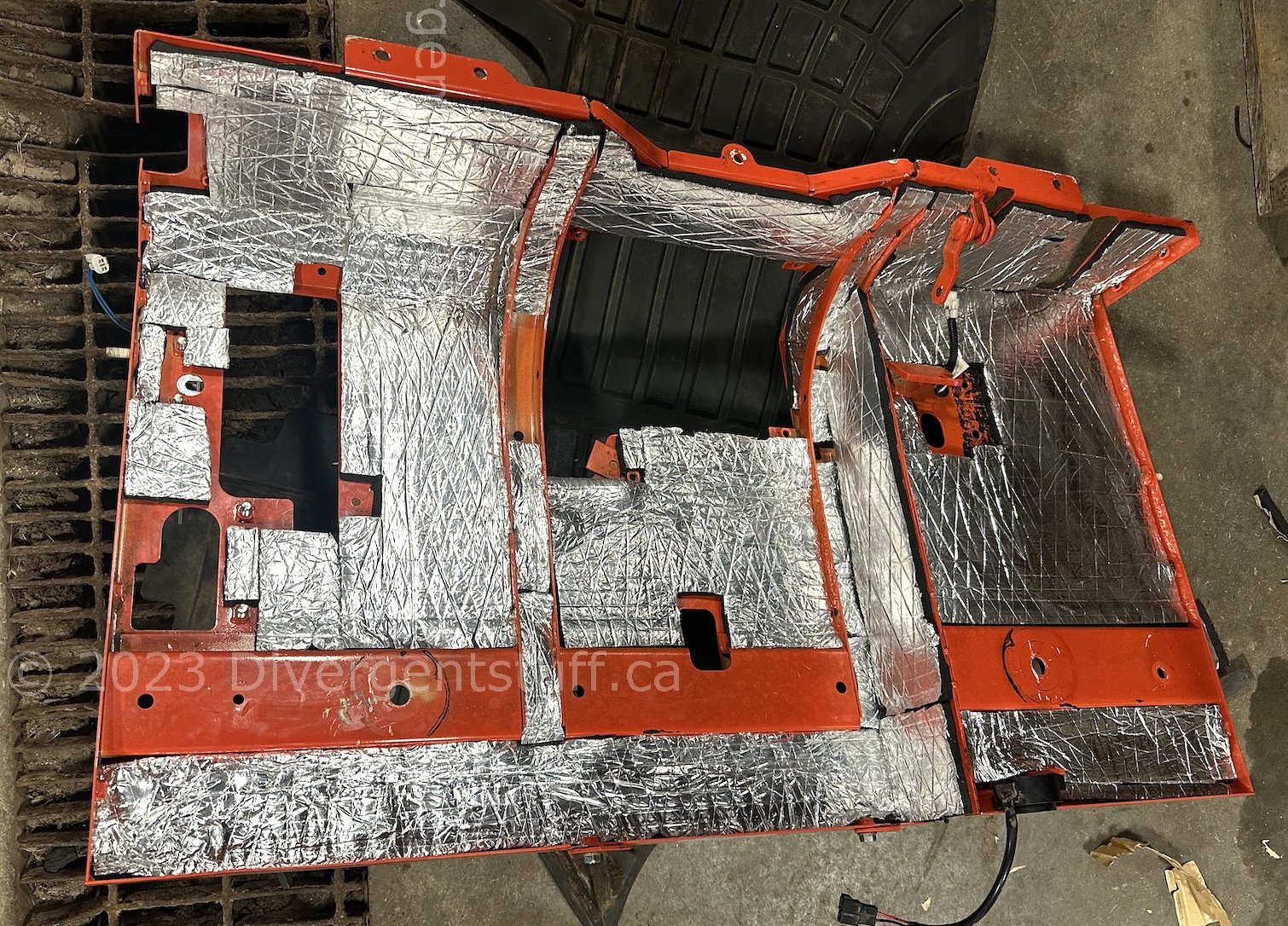

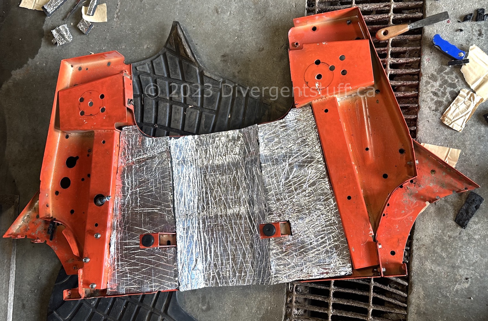

If you decide to put on a cab I'd recommend installing the fire rated noise isolation foam under your floor and under the roof. I honestly think it's a little quieter with the cab than without but it gets freaking hot in the cab in summer if you don't have A/C. Opening windows isn't enough. I get a ton of heat through the floor from the tranny. The foiled foam does help mitigate some of the heat.
On the plus side I can snowblow in my shorts and T-shirt at 0F. On the minus side I can hit +120F in the cab with all the windows open in summer. Thankfully we have a cooler climate here 8-10 months per year.

I have some health issues that limit what I can do underneath the tractor.
What do you think about installing the noise insulation or something like thick stall mat material between the floor and the existing mat?

I blew a main hydraulic line this summer so I had to pull the cab and floor deck off to get at it. It would be impossible on my machine to put the heat shield sound proofing under the complete deck without removing it.
On my M59 the OEM rubber floor mats have push through friction fasteners as part of the matt. Putting something under the mat wouldn't work well. My cab kit came with thick foam floor matting that goes over the OEM rubber matt. It gives you some sound deadening but it doesn't seem to help for the heat problem.

I guess it's time to look at my options.
Thanks much for sharing your experience.
