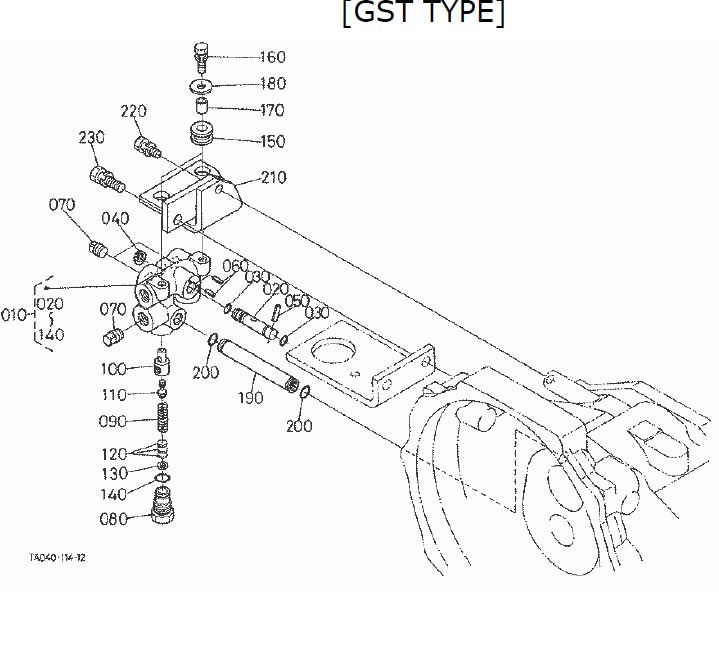

Can someone please tell me where the hydraulic pressure relief valve is on a 2004 kubota l4610 and also if anyone has any expierence shimming these to up the pressure my dealer told me the pressure is set very low from the factory and can be turned up considerably thanks Sean

I curious as to why your dealer didn't point out where the relief valve is located if they were advising you to increase relief valve psi? Your tractor being hydro-static drive I would be hesitant to change factory settings. Here's one relief valve I found.

The dealer I talked too, I was inquiring about a plow I'm buying and I just mentioned it too him and he just said you have to shim the relief valve to up the pressure no I don't know if he was talking the loader relief valve or the hydraulic system relief valve. I know this is a very common adjustment I just can't seem to find the info anywhere I may have to buy a service manual to get the info
