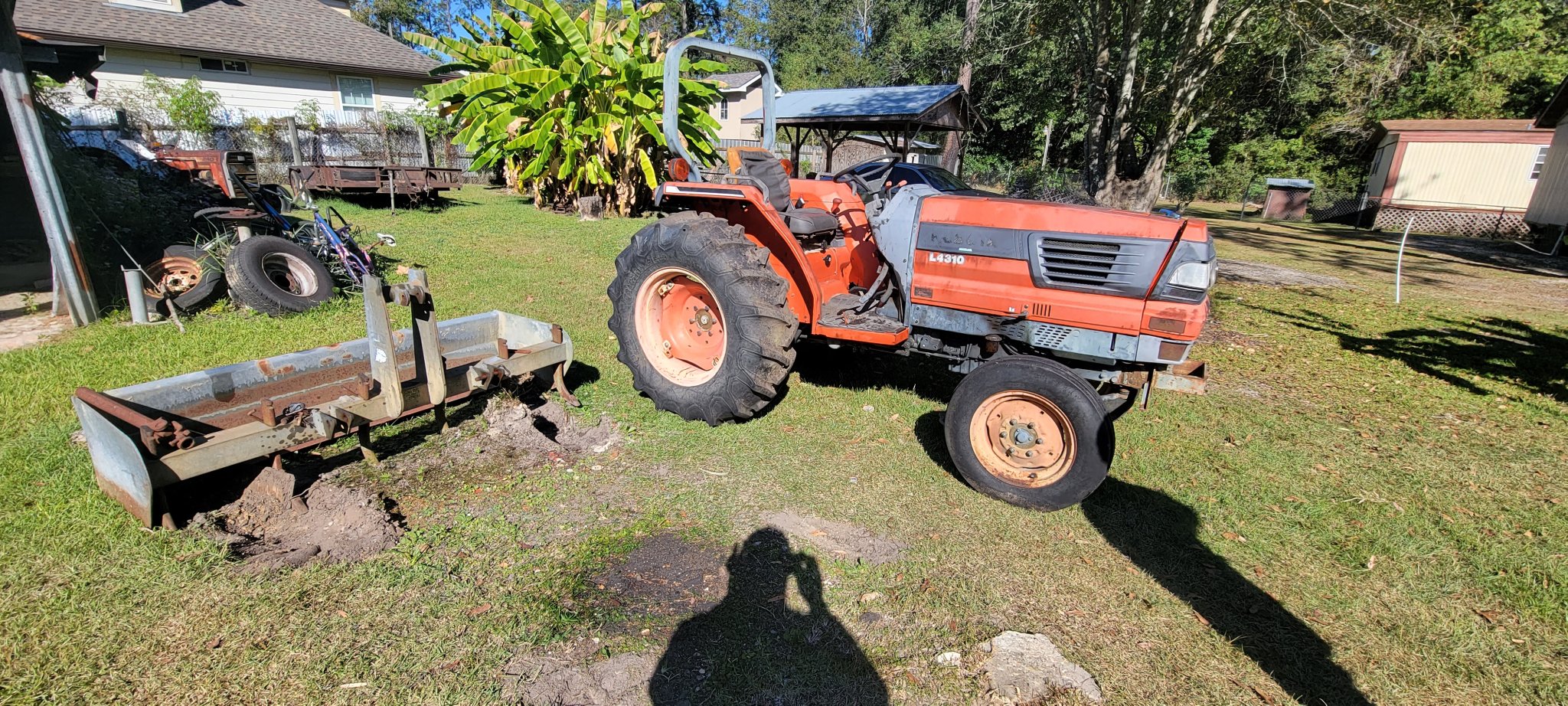

Me and my father brought a L4310 tractor and drag box a while back. Tractor runs like a top but has absolutely no steering what so ever. When we got it home and got it up and running the steering would work very little then after about an hour it completely stopped working.Even with the engine off it doesn't have any steering.
