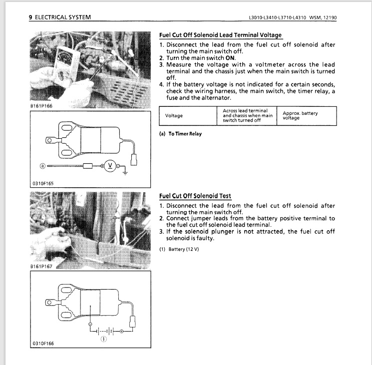

Your tractor applies power to the stop solenoid for a short period to stop the engine. That is where the timer relay is working.
Other tractors need constant power to the solenoid so the engine can run.
Start by looking for a blown fuse..... 5 amps from memory.
Here are the relevant pages from the WSM

Get a schematic for your tractor. You problem is probably somewhere in the fuel shut off solenoid. With older tractors you could completely shut the fuel off with the throttle. Somewhere along the line designers decided to no longer do this. The fuel now passes through a shut off solenoid which interrupts the flow of fuel when you turn off the ignition. If it doesn't turn off the fuel the tractor keeps running.

If your diagnosis confirms a defective timer relay as per Dave’s instructions, this will save you some cash. L4310 is on the list.
