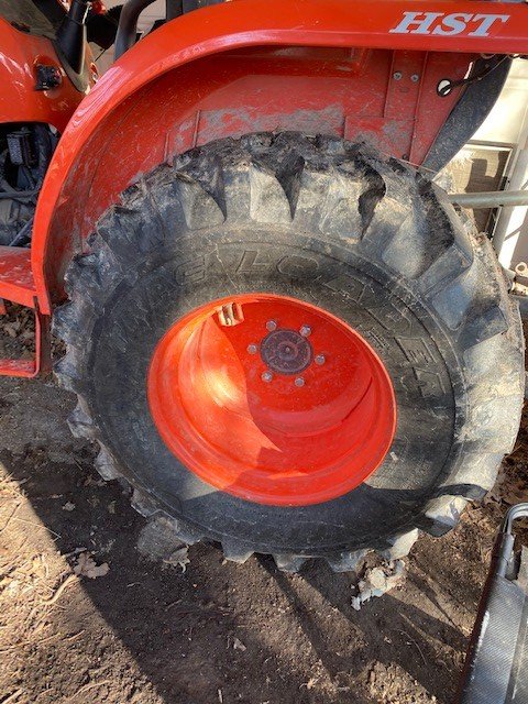

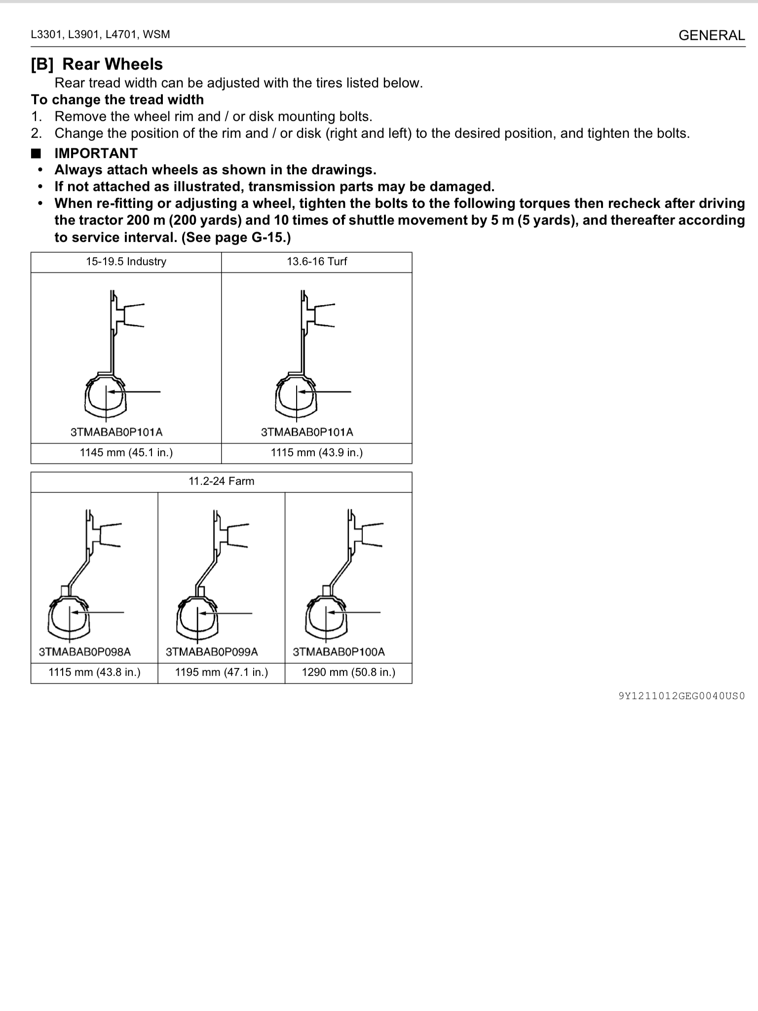

The manual (attached) mentions the ability to adjust the width of the rear wheels. In looking online, I've seen 2 piece rims, which I don't have. Are these tires adjustable or do I Need to buy spacers?

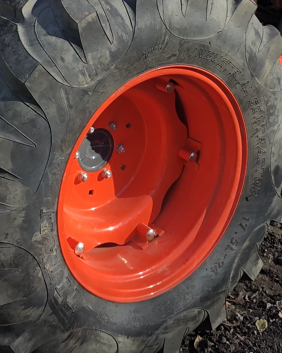

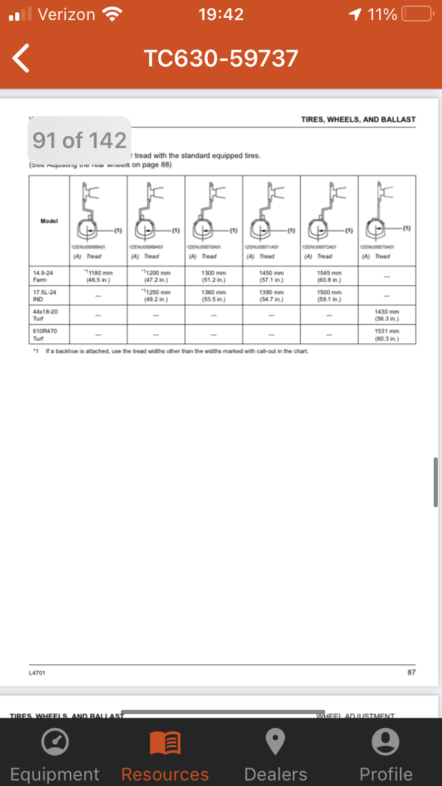

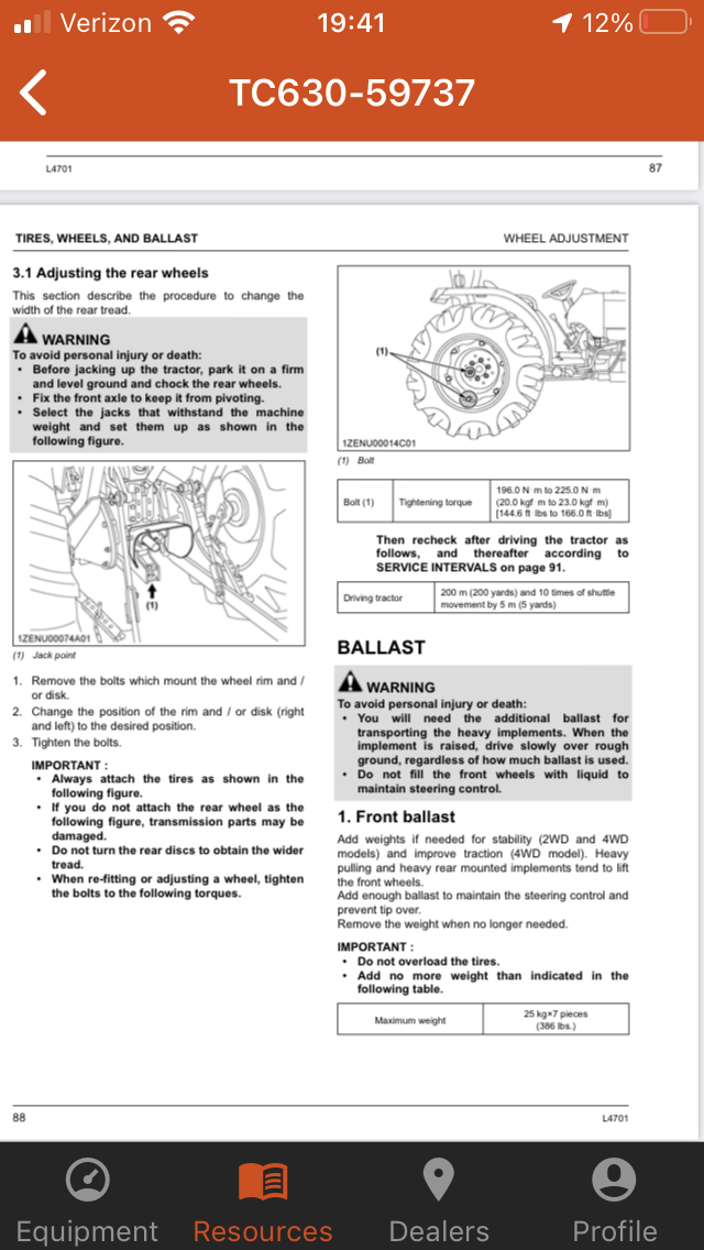

The rims on my L4701 are adjustable per the manual, dealer, and design. They are a two piece rim with brackets on the outer rim that are offset from the center line of the rim. The brackets can be set inside the center or outside the center which moves the wheel the width of the bracket plus the thickness of the center plate. Swapping sides with the rims while keeping tire tread facing same direction effectively flips the outer rim around and gives two more width options. As shown in the excerpt from the manual, there are four optional widths with The 17.5-24 R4’s on the L4701. The options for R1’s are different but R1 v R4 is not the controlling factor in adjustability. Whether it’s an 01 or 60 or M or B or L is not relevant. Whether the tractor has a two piece rim or a one piece rim and the available clearances control whether you can adjust the rim.
The issue you have, which you can see in the picture of your rim v mine, is you have a one piece rim (your rim doesn’t have the outer ring of bolts). Only way to adjust a one piece rim is with spacers.

The WSM shows three different tire combinations with the 11.2 x 24 farm package. All three set ups reference the center disk cupped in the out position, while the disk can be reversed to face inwards I don’t believe this is feasible on the L25, 33 or 39 because it would contact the inside of the fender to frame area.
