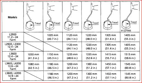

Actually it looks like he could go wider. ;)
Swap the rims side to side and bolt the centers to the inside of the farthest inside tab. that will move it out even more. :D
While this is not your tractor model it gives you a complete picture of the ways to space it.
