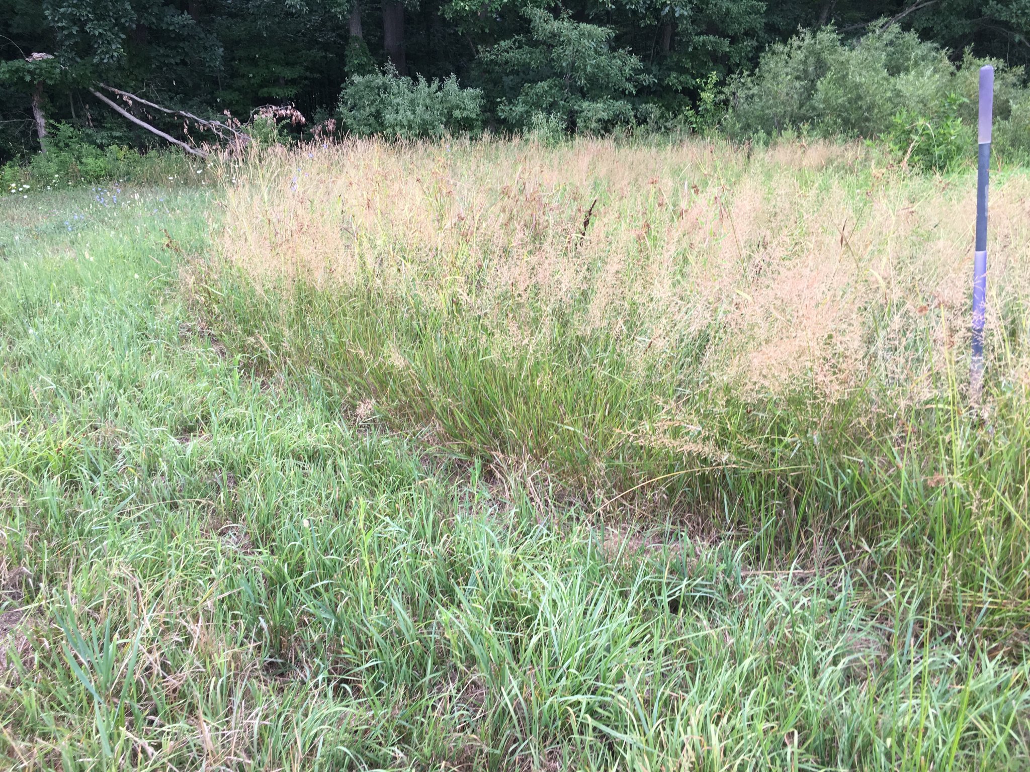

Looking at purchasing a L3901 (32hp pto), L4701 (39hp pto), or MX5400 (46hp pto). Wanted to get advice on what the right tractor for my use is. Looking at 4wd HST with loader on all models.
The primary use is to rotary cut about 15 acres. Grass can get thick at times (usually in spring) but I try to cut it once a month. Will either use a 5 or 6ft cutter. Regardless of size I use I want to be able to go about 3.5 to 4 mph. I have attached a picture of the worst of what it will be rotary cutting. That’s about 3 ft tall.
Other than rotary cutting will be used to snow blow and light loader work. View attachment 47022
That's a lot of mowing. I wouldn't consider a 5 ft mower. Will the MX lift a 7 footer? Also, SSQA and 3rd function for that grapple you need.
I just got an MX5400 and used it for the first time this weekend for about 8hrs loader and backhoe work. I looked at the L4701, but the price difference to bump up to MX5400 with the additional stability and weight, I am in hilly WV, it made more sense to have a bit more power and be able to use larger implements. For brush hogging I would go with the heavier MX5400 for being able to pull the 6' brush hog.

Thanks for all the advice. My local dealer has a l4701 and a mx6000. Going to get quotes on both but I know the MX is going to be substantially more.
I’m probably going to stick with a 6ft cutter because I’m too cheap to buy a 10 or 12ft and I question the ability to run it in tall grass with that low of an hp tractor.
Right now using a borrowed tractor and a 6ft cutter. I can get through it in about 6 hours but that’s at around 4.5 mph per speed tracking app. The tractor I’m using though is 60 pto hp. If I can at least keep the speed at 3.5 mph I don’t think it will take too much longer. And it’s only once a month.
Looks like I have narrowed it down to a l4701 or MX5400/6000. Leaning towards 4701 due to cost. But the drop of 20 pto hp concerns me, but I’m sure 60 pto hp is overkill?
I only still have my 4ft cutter leftover from my previous smaller tractor. I have no doubts that my L4701 HST would run a 6ft cutter through my field that gets dotted with 1" saplings. I've found that a lot of Cat1 implements like cutters have 40HP gearboxes. If you got more than that at the PTO, you will probably need to consider Cat2 implements = more $$$. The L has a smaller front axles and wheels, so it will probably turn a tighter radius, while the MX will probably handle transporting heavier loads in the bucket with a beefier front axle. I was also considering an L3901, but stepped up to the L4701. I briefly looked at the MX4800 which everyone said was a no brainer over the L. I decided that the L was already overkill for what I need and took the $1200 I saved to install third function and a set of rear remotes. I have no regrets.

I do not see anything in that photo that would give any of your choices a problem. If the whole area is the same you can go with any of them. I routinely do my 8 acres with my L4400 (37.5 PTO) and a 6 foot Bush Hog 286 in about 2.5-3 hours. Now I keep it cut very short, as it is part of my 'yard'.
Personally I would probably bump up to the 4701 for resale and power.
dochsml brings up a good point about HP rating. We've had a Bush Hog 286 (6') for about 25 years with no problems. Just keep it reasonably clean and in a shed to keep wet grass from making rust. It has Class I (II optional) hitch and 110 HP rated gearbox. Brochure says 2-1/2" capacity and I've cut an occasional sapling that large. It weighs 900 - 1000 lbs and the Ford (model 3930 - 50 HP 2wd) we pull it with has plenty of power, but gets a little light in the front when it's lifted. I would just warn OP to make sure whatever he buys can safely lift the cutter as well as power it. I assume the FEL and 4wd add enough front weight on your L4400 without additional weights?
