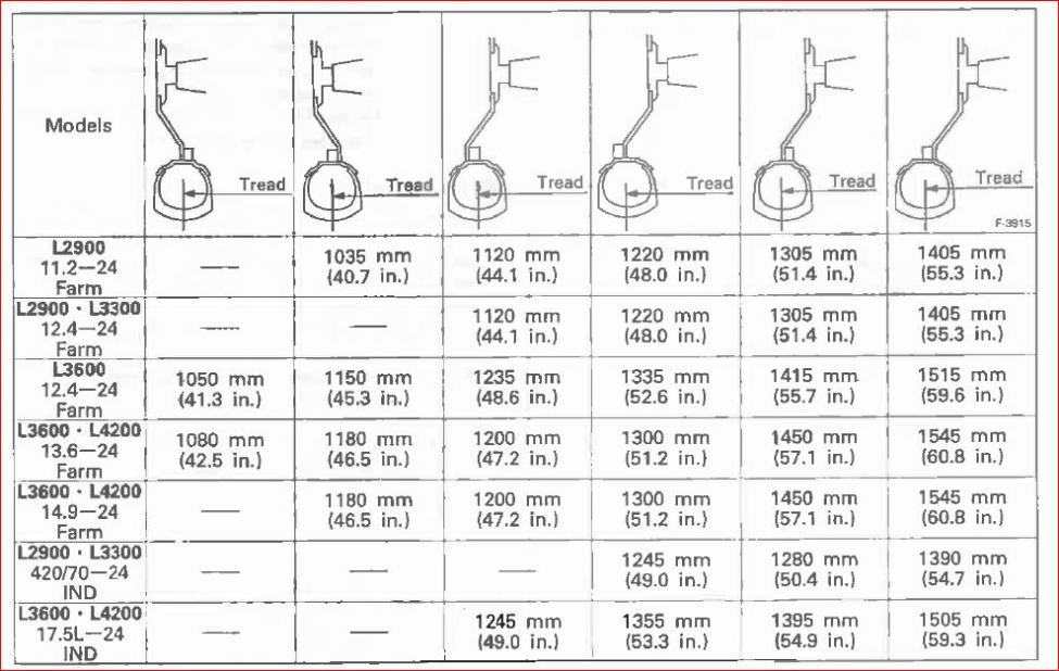

I thought a had left my manual at the camp but I found it in my truck so I was able to answer some of my own questions. I looks like my rear wheels are set to the narrowest position. I should be able to change my rear wheel width by about 7” from 43.8” to 50.8”, center to center. According to the manual, I can’t increase the front wheel width.

I could certainly be wrong, but it looks like the setup in the picture only offers one more opportunity to make the wheels wider, perhaps an inch or so per side?
Am I missing something? Won’t be the first time...:confused:

He's actually in position 4 of 6 he can move them two more steps, by spinning the outer rims and moving them side to side (just to keep the tread going the right direction), then bolting to the far inside of the outer rim. ;)

Well, it’s been almost a year but I finally got around to moving my rear wheels to the outermost position. It was $80 well spent at the dealer. I took my L3800 back to the camp today and the wider rears made a world of difference.
