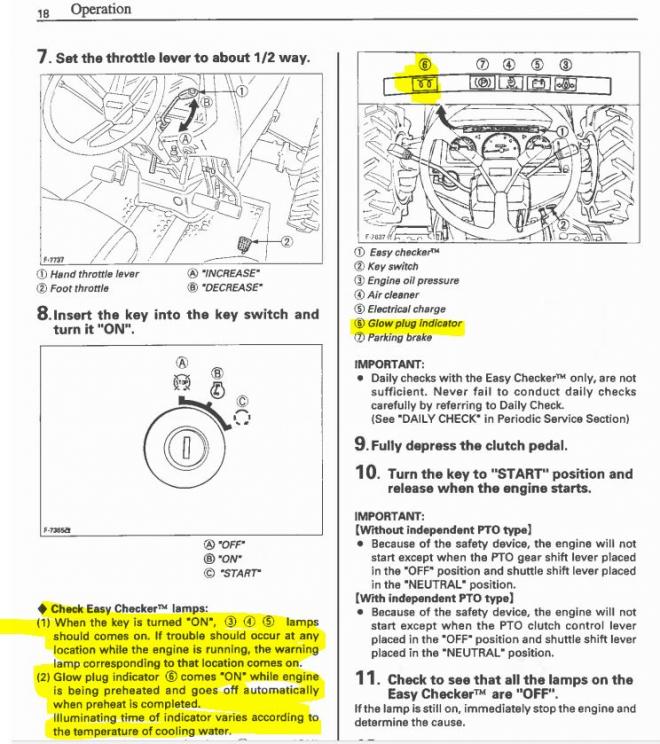

According to the manual it is supposed to turn on when the key is in the on position. It's a 3 position switch. Off, on, start

See if this helps:
the light could be burned out.....test this with ohm meter
the wiring to GP could be at fault. see if 12+ volts are getting to top of plugs
YOU could have a bad GP too. Easy to test with Ohm meter, must remove connection at top, should be lower than 10 ohms, more like 1 ohm!!!
