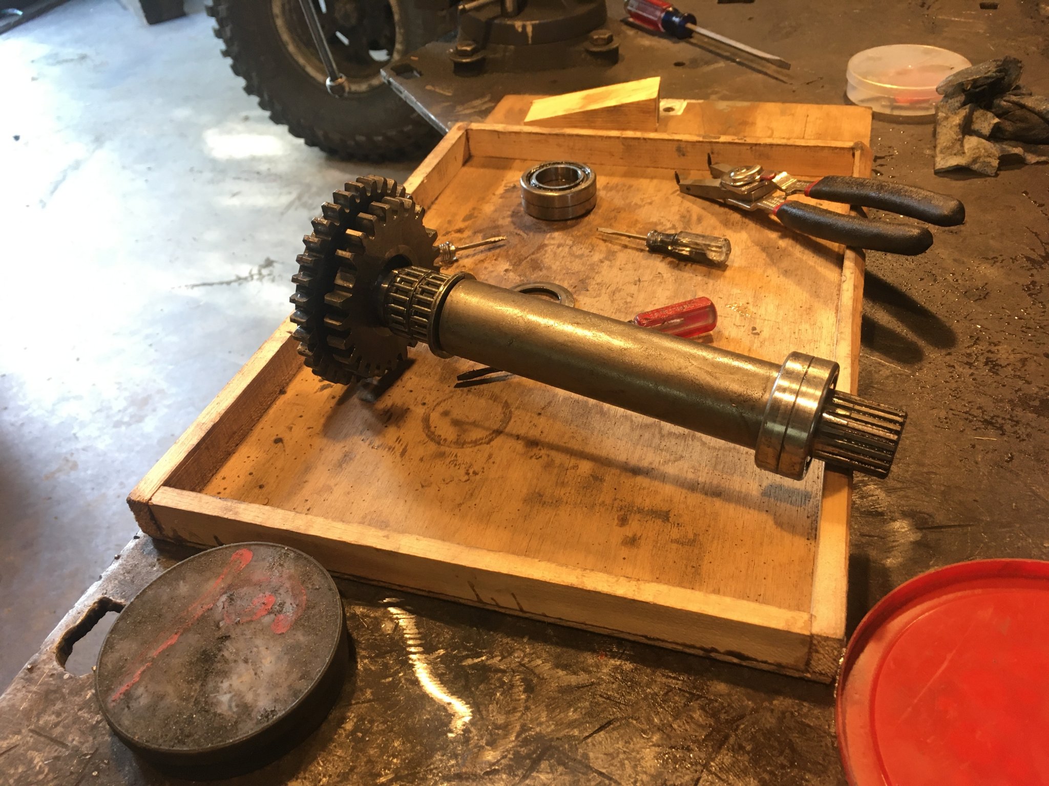

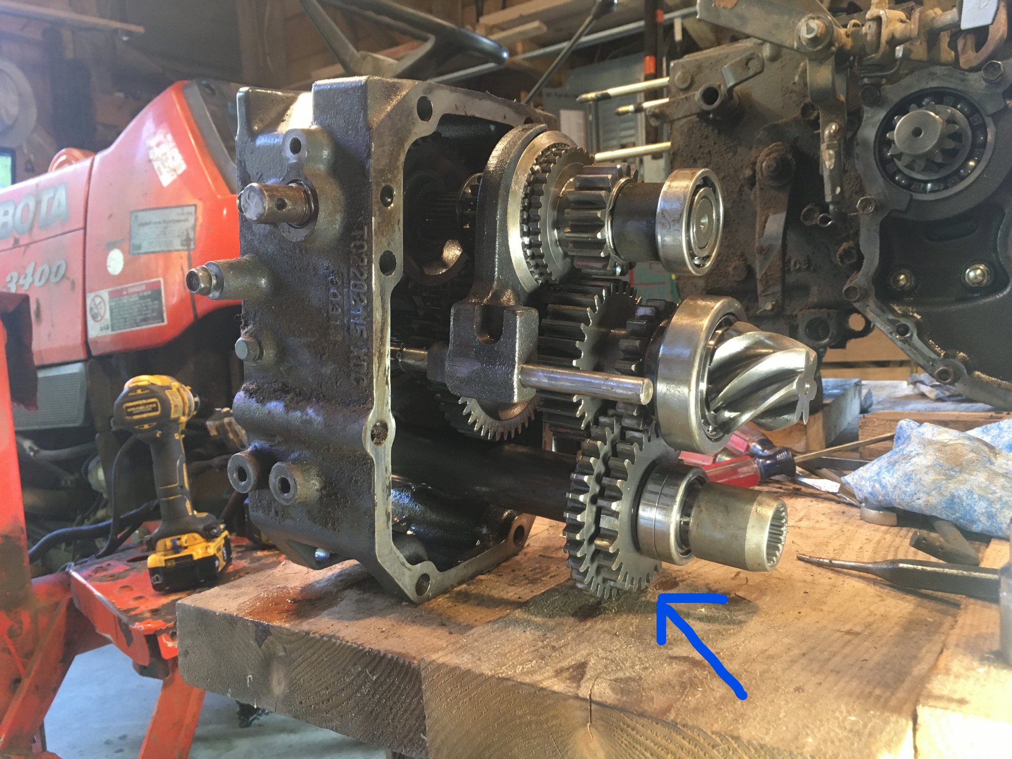

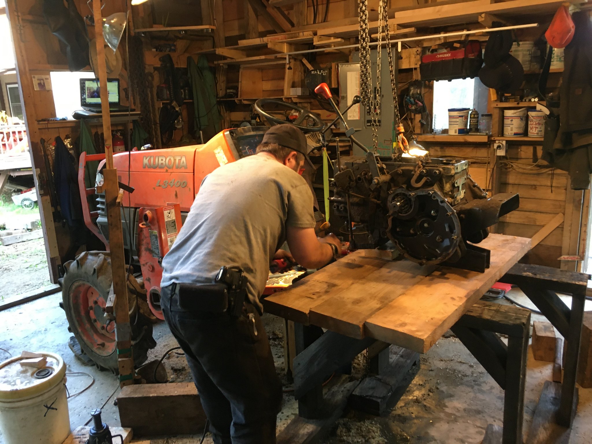

At the point of no return now, one gear with two missing teeth, couple bad bearings on pinion shaft, then the right side axle is bent, that was $600.00 and showed up yesterday, now waiting for the rest of parts, total cost so far $1,200.00. Hoping next week rest of parts show up and also hoping my son can remember how it all goes back together............
