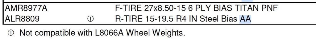

Talk to the sales department as these order code numbers are Kubota Wholegoods numbers which include the R4 tire and wheel, I believe these numbers are 1 each so you will need to order 2 of each:
Front: F-TIRE 27x8.50-15 6 PLY BIAS
ORDER CODE: AMR8977A
Rear: R-TIRE 15-19.5 R4 IN
ORDER CODE: ALR8809.

Below is a snap shot of the 2011 whole goods catalog I get this info from. It says Titan for fronts but doesn't say a brand for rears. I have R4 Titans on my L4701, no complaints with them.

This was a big help, thank you. Ended up ordering them from Hoober's online store. I called them and they were able to pull these exact numbers up. Should be getting them by early next week!
