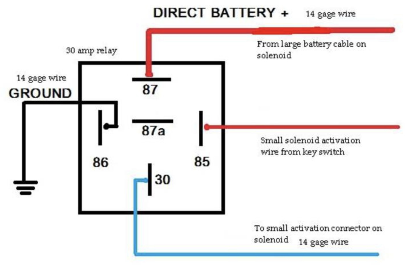

I ended up going with an Interstate Group 31 battery. Cables all cleaned up, turned the key for the first time in nearly a year, I heard the starter and fuel solenoid click, but the starter didn't turn. After turning the key on/off a few times eventually the starter engaged and tractor started. I let it run for a while, shut it off. Started the tractor again a few times, no problems. Today, same thing again. I do own the Kubota service manual, any suggestions as to where to start troubleshooting?

Have the starter and solenoid checked out for proper operation (or do it yourself).
Clean the safety switches or add a relay that is controlled by the existing wire to the starter solenoid (black with white wire?)
Search for starter helper relay but here is the schematic of how it is wired.

If all else fails remove the starter and clean the mounting surface on the starter and the block with emery paper. That is part of the ground system.

Thanks for the response, I've done the starter helper relay on my TG1860. As mentioned, tractor has sat for almost a year under a car port. I do hear the solenoid click when I turn the key. I'll check the safety switches and test the starter and solenoid, thanks again.

Thanks to all who have responded, the starter helper relay did the trick. I did same on my TG1860 with much smaller wire and more safety switches in series, never thought it was applicable on an old 1986 L3350.
