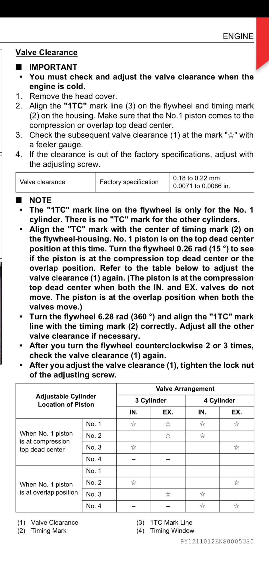

The actual process of adjusting the valve lash clearance is very basic if you follow the chart in the WSM.
Problem is, the hood, fuel tank, some electrical and I am thinking some exhaust after treatment has to be removed to access the rocker cover.

WSM specifically states it’s to be done ‘cold’, for this one
6,103
3,391
The Kubota valves are adjusted COLD. .008 in most instances.

the adjustment isn't terribly hard. Getting TO the valve cover is the challenge. Brackets, fuel tank, etc-all has to come off. WSM outlines it.
I also have cars with solid lift cams, or should I say solid roller cams. Gotta check them once in a while. The clearance spec is on a hot engine. So what I do is warm it up, pull a valve cover then check them. If in spec (usually are) let it cool off overnight and check them cold. The cold spec is usually tighter than hot So now I know the cold spec, I can check and adjust cold rather than swimming in hot engine oil around hot header tubes. You get the idea.
BTW on the L3301/3901 the spec doesn't change much between hot and cold. The block/head do expand and contract with heat but so do the pushrods and valves; and close to the same rates.
