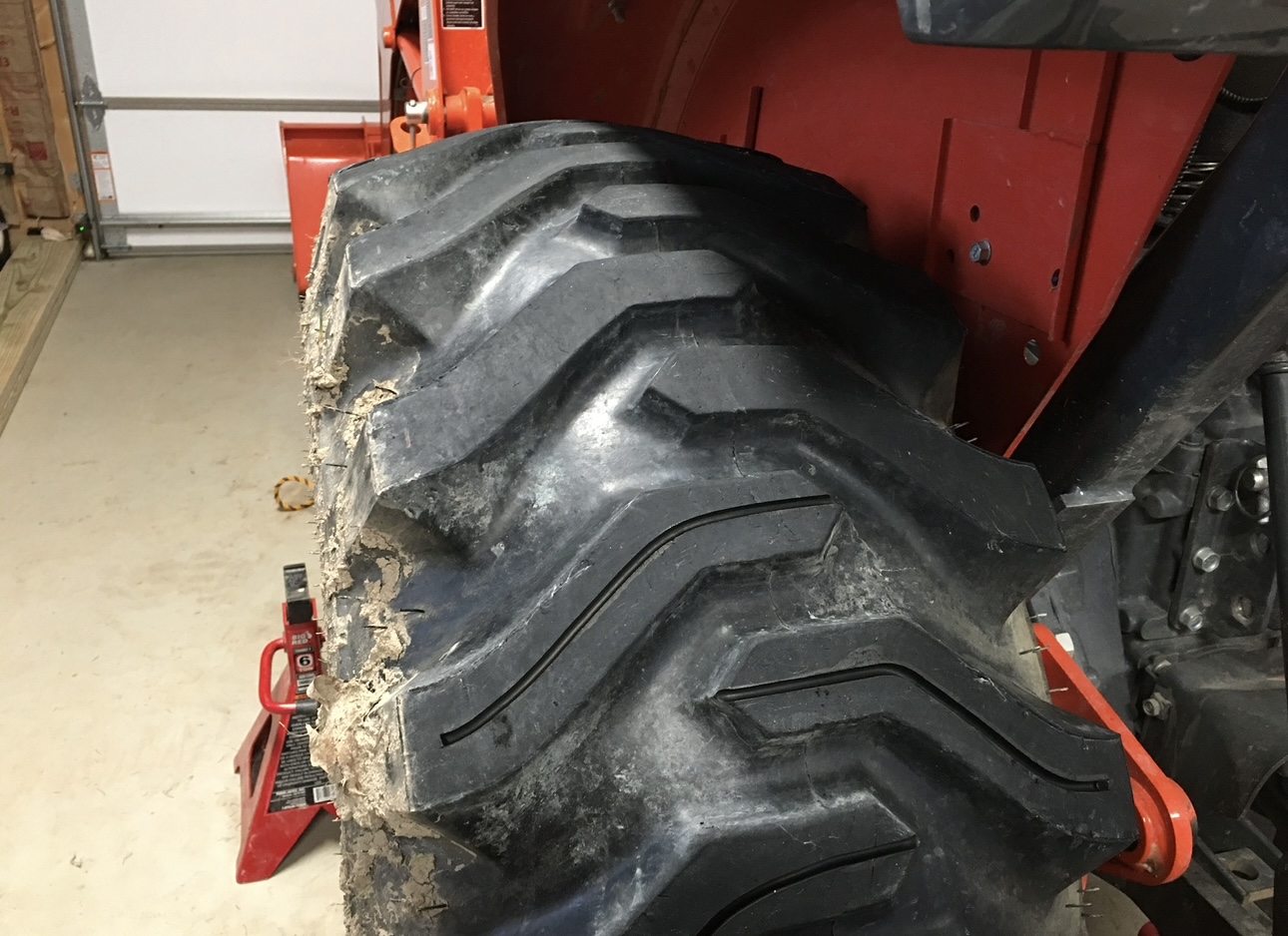

I had siped (grooved) my R4 tires since I’m reluctant to go with chains. I do keep snow in the FEL itself when it starts to get a bit funky.
Just came back in from the same situation you had. Started as snow, then we had melting, then freezing rain, and then more snow. I just did my ice breaker routine with the piranha bar across the FEL and pushed it away, easily.
I went the siping route too thanks to @pokey1416 very kindly sending me his siping tool to use. I don't think I would have necessarily bought a tool to do this, but I feel like it makes a difference to traction.

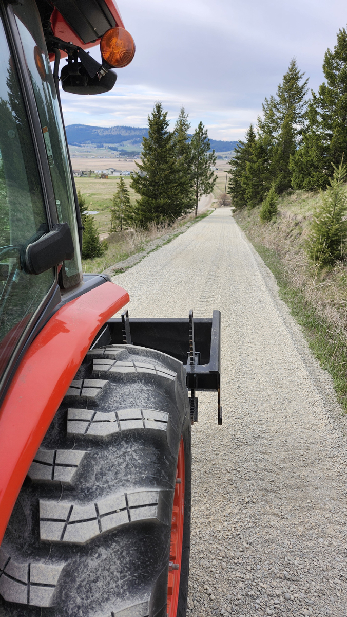

I have steep driveways to deal with, both gravel and asphalt, with a couple of sections on the asphalt being the most challenging. I can blow snow uphill on those steep sections with no trouble at all and I think the siping is a part of that. I don't run chains any more.

I have hundreds of yards of driveway to deal with and 9,000 sq.ft of asphalt with some of it steep
He didn‘t ask how much asphalt you had either. Fwiw, you pictures look flat in comparison to what most would consider steep. :D

There's more than a 120ft elevation change from the road below me to the parking area in front of the house. The lower driveway is close to 200 yards long and the upper driveway is 175 yards long. The average grade based on the elevation change over the given distance is almost 11%. There are some sections that are less of an incline than others, so if the average is 11% there must be sections steeper than that. Yep, that's not steep at all. 😂😂

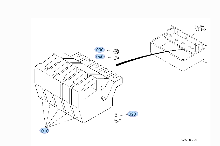

As a starting point, Messick's has front weights for your tractor. Do you have the front bracket shown in the schematic? The factory weight option and bracket would be the easiest way to go but depending on your fabricating abilities you can wander off into the weeds as much as you like.

You could buy the bumper from a Kubota dealer which is "only" $209.63 and then buy weights from another supplier. There are two weights available from Kubota for the L3901, i.e. 44lb and 55lb each. They are expensive at around $370 each.
Good Works Tractor Co. sells 41lb weights for $149 each and 70lb weights for $175 each (better deal) so it might be worth figuring out how to make the Kubota front bumper (weight hanger) work with other weights.

Don't order weights though parts. The front weight bracket is MX8068, and the 55lb BL8069 front weights. These are sales dept accessories. Does not include freight, which can get expensive for weights. There is also some hardware needed so the weights do not bounce off the front bar. Thats a few dollars too. We have a call center full of people who can help with this stuff.
