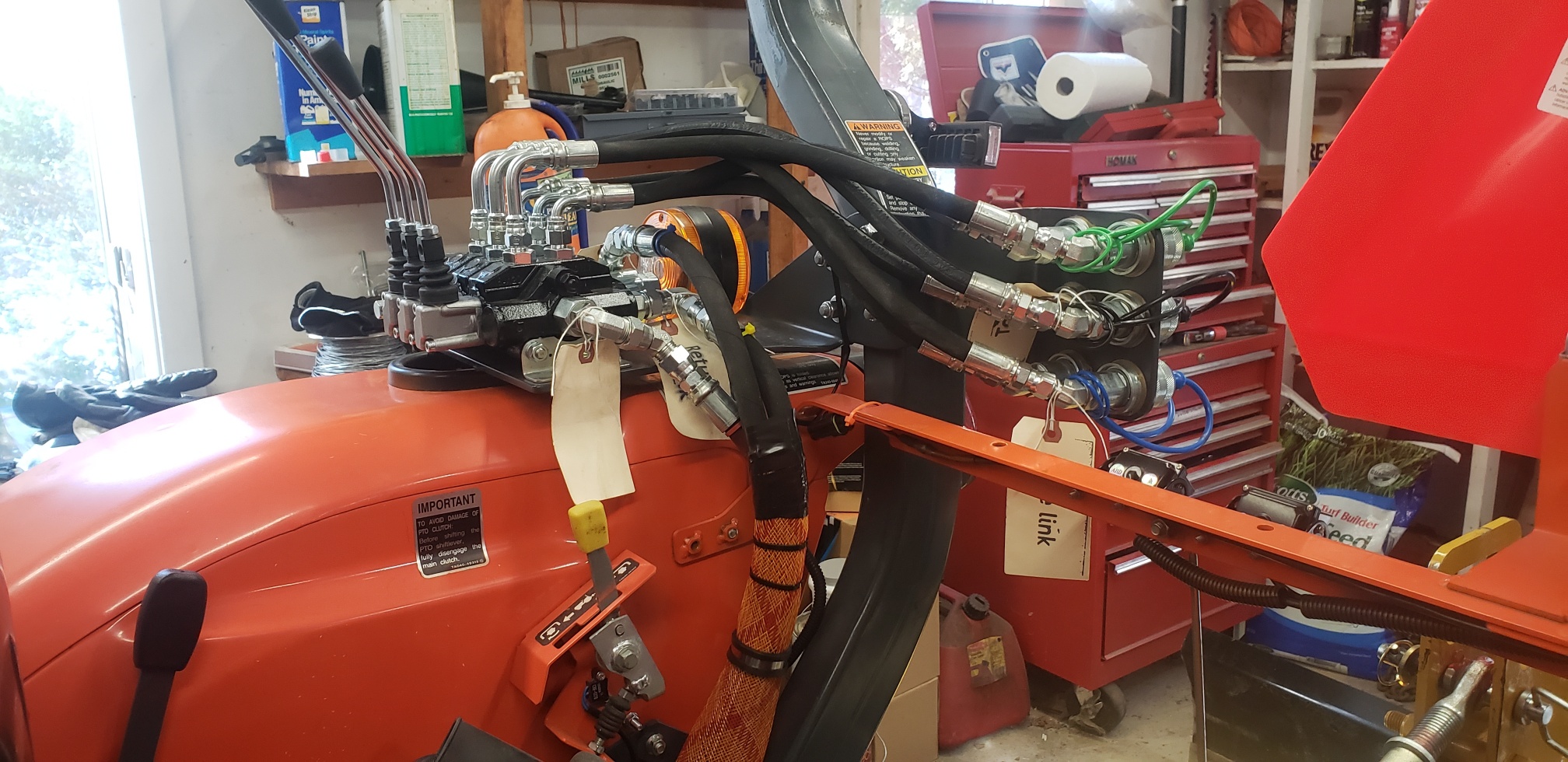

fwiw I filled my rears and added 3" spacers on my L3800. I have EA's 6' box blade. They recommended I not go any bigger. There are occasions when the box fills that I do lift it ever so slightly to dump some material. Last fall I used the box and back blades to regrade my driveway. It was a pia on and off to adjust angles. A top and tilt would have saved me a ton of time.
That said I just finished installing 3 rear remote valves. Two for the top and tilt kit I have coming from FitRite (I also got all the rear remote components from Brian). The third is for the 'what you don't know'. Brian was super helpful in guiding me along. When I say I was a novice with hydraulics, its no exaggeration. It turned out to be a whole lot easier than my concern in doing it.
If you can handle Brian's long wait time for a top and tilt it may be something to consider.
