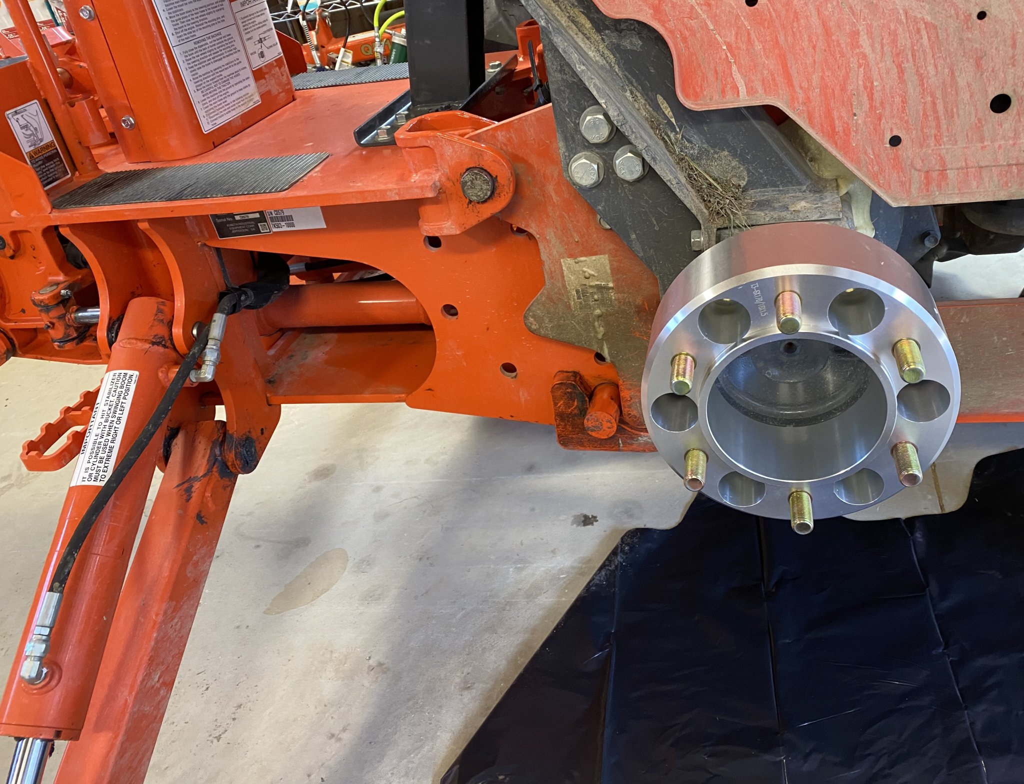

I ordered in 3” Bro-tek Spacers to enable this on my 3301 with R4s (and just widen Butch up a little). Great customer service from Richard at Bro-tek. Now I’m looking around for the easiest way to pull my loaded rear tires off without breaking my back. Actually ‘pulling’ them off won’t be hard—it will be putting them back on. I won’t be widening the front.

Likely depends as well on other factors such as chain type and fit. I picked 3” spacers because those gave me the equivalent width on that rear as R1’s have that themselves are moved all the way out. I’m on hills a lot so that was really my primary reason. I haven’t even procured any chains as of yet.

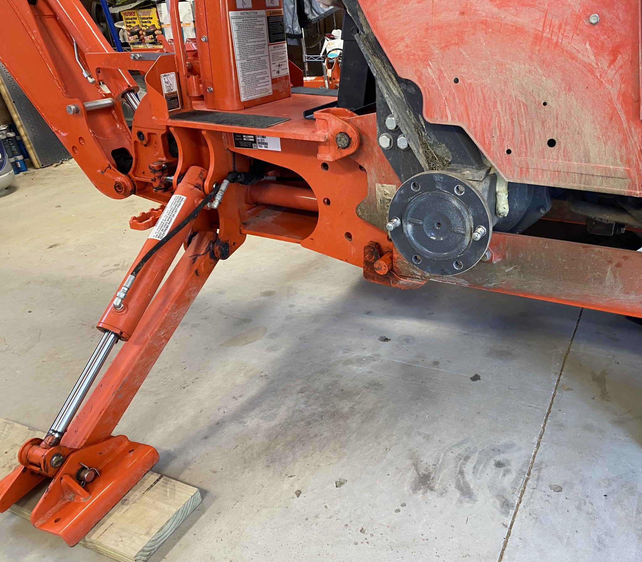

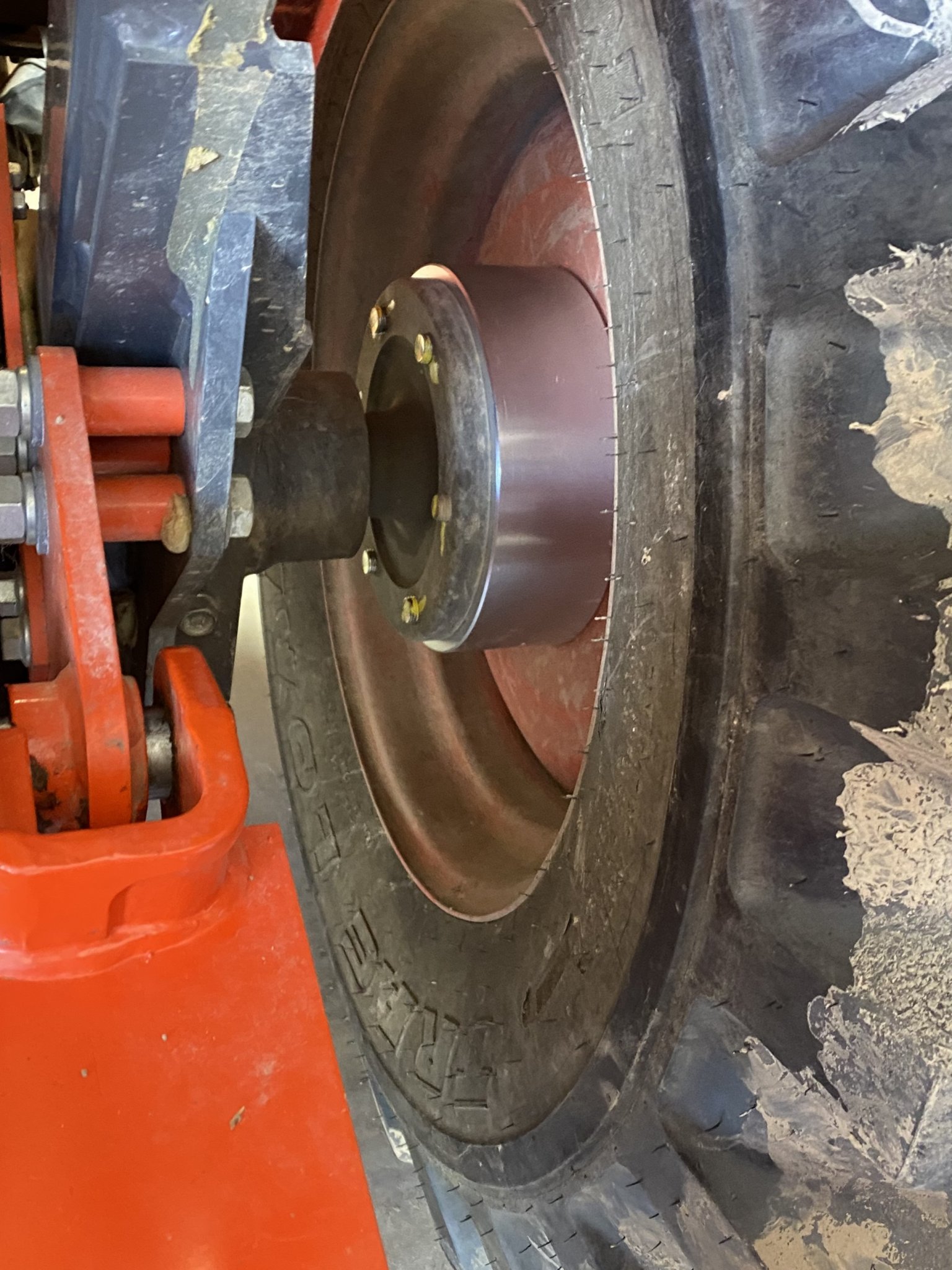

As much as I liked using that tire dolly I picked up off Amazon, the backhoe itself really made the job easy.
