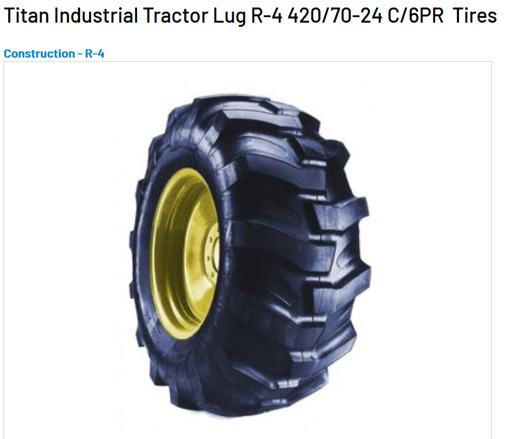

My L3030 owner's manual shows Industrial (R4) sizes as:
Rear - 420/70-24
Front - 10-16.5 (like many skid steer tires)
airbiscuit
New Holland T2310, New Holland TC21D, Kubota l3010 GST, Farmall H
Mar 18, 2021
88
53
NW WI
R1 = 11" rims R4 = 13" rims

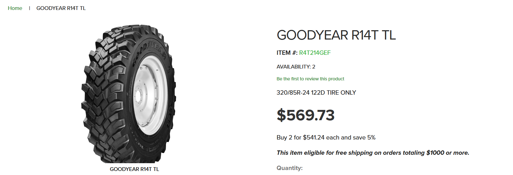

One other thing is that you might consider R14s. They supposedly make them for both R1 and R4 rims. That would save you the cost of new rims and still give the same offset.
airbiscuit
Mar 18, 2021
88
53
NW WI
These would fit your current rims and same diameter as your R1s, but $$$
