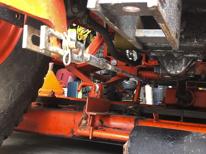

Beyond that, I still haven't figured out the best way to reach beneath the L3010, and thus, I find working on it (attachments and maintenance) somewhat inconvenient/difficult. This principally because I'm an oldish short fat dude (so I'm not exactly spry and flexible). Makes getting down and back up tough not just on my knees, but lower back, also. Along these lines, I have a 2-post lift for farting around on cars, which means I am still pondering the issue.

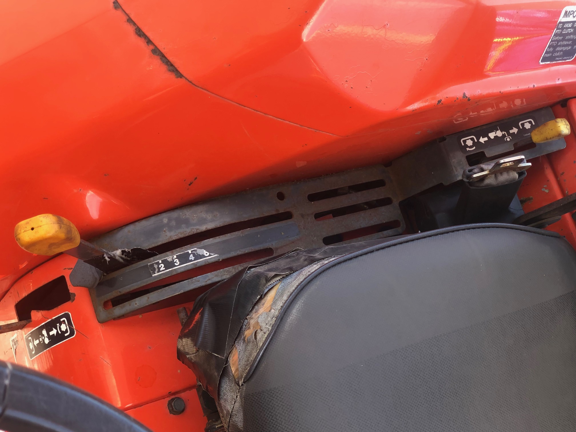

I think your L3010 has "position" control and not "draft" control as you noted.
Your position control has that black triangle shaped knob that is adjustable to allow the 3 point implement to lower to your pre-set height.
Useful when using certain implements such as a box blade. In a nut shell your lift arms will drop when moving the lever to the height you set with the black knob. The key is being repeatable.

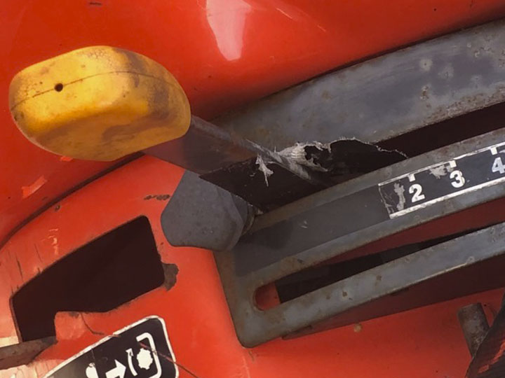

ken erickson wrote regarding position control and a triangular knob - but - unless my eyes (and fingertips) deceive me, I'm not certain my tractor has this, either.
And as regards the knob below the front of the seat by which I adjust how quickly the implement attached to the 3-point is lowered, I'm aware of how this works and its purpose. And I don't believe this is what's being reference. So kindly tell me more about position control if it exists on my tractor, please.

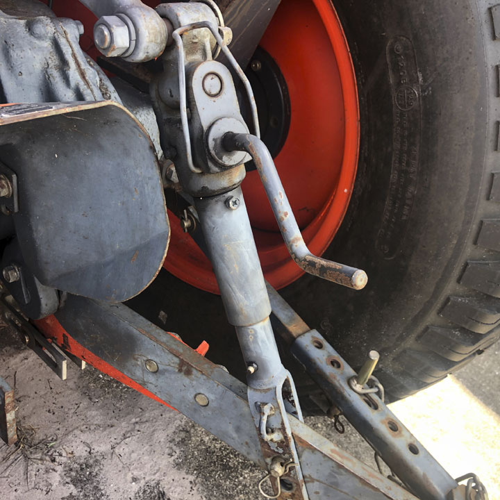

Meanwhile, as this may relate to position control, what is the purpose and how is this used - an screw-type adjustment mechanism on the 3-point hitch. Unstowing the handle allows me to use a screw mechanism and adjust 'something' as it relates to position, but only the one side as the other is of a fixed length. That, and I presume only one side needs adjusting because otherwise, Kubota would have include two of these adjustment mechanisms!
Anyway, I'm all ears regarding purpose and why there's only the one.

The position control adjustment knob is located below your 3pt lever in the picture you posted earlier. It just limits how far down the 3pt lever can go down. Or up if it’s placed above the lever.
The side link adjustment in the post above is just that. To change the side to side angle of your implement such as a scraper blade or box blade.

Ken was referring to the small knob with a black triangular head beneath and in front of the large handle with the yellow plastic top in one of your previous pictures. You can loosen the black knob and slide it up the slot and re-tighten it so it will only allow the lever with the yellow handle to go down so far. That's the position control adjustment.
The handle with the screw adjustment changes the height of the lower 3 point link on the right side of the tractor. Cranking the screw in one direction makes the right link higher than the left link; cranking it the other way makes the right link lower than the left one.
This serves the purpose of tilting whatever is mounted on the 3 point in one direction or the other. You probably wouldn't have much need to tilt a mower like that but that is very useful for implements that do grading, leveling or moving of soil or other material.

Good grief, I'd never noticed the triangular position control knob!
For sure I'll go fool around with this knob tomorrow. So this is basically a mechanical stop, like a limit switch, for the down position, eh? Great, now I won't have to work so hard when using the 3-point mechanism!

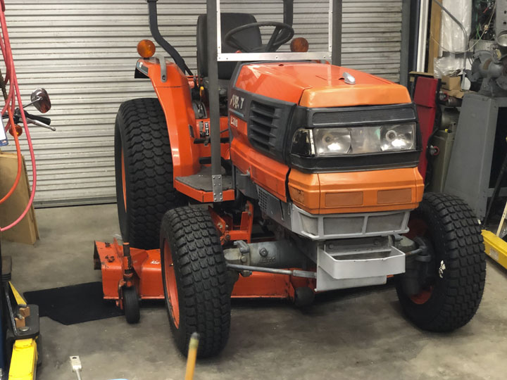

Speaking of which, the 3-point mechanism raises and lowers the mower deck through linkage rods. They weren't at the correct length (or even the same) but now they are (900mm per the manual).
Also, while the aft clevis pins are the correct ones, the set in the front were too slender and lacked washers beneath the hair pin cotters. I've now got the correct ones in hand so I plan to reassemble the linkage rods tomorrow. Once I've done that I'll be able to fool around with setting the proper height of the deck using the position control knob.

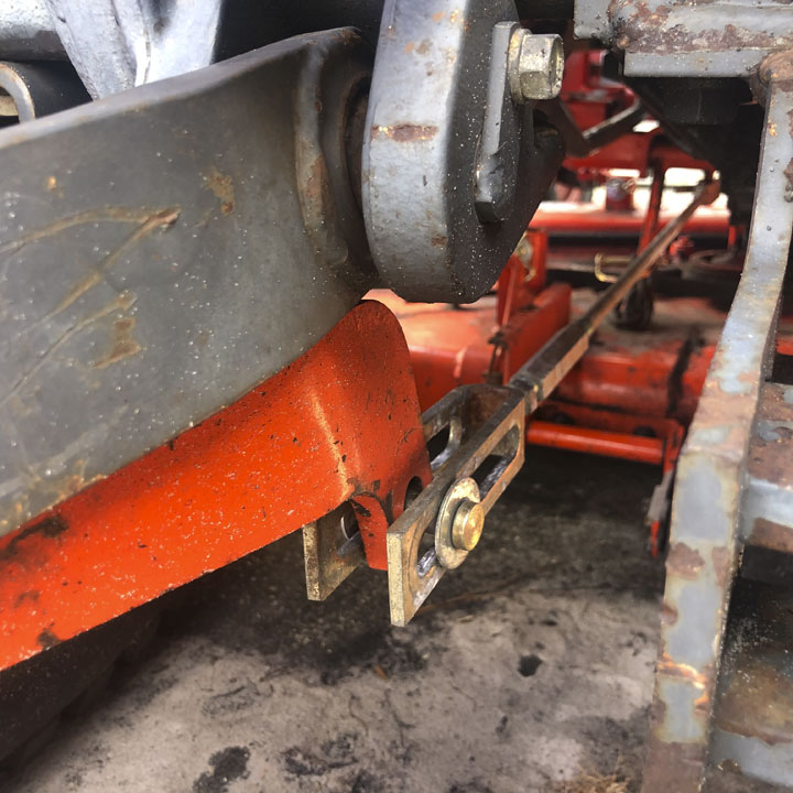

But I have a problem. Following the mower deck manual, the rods are set to 900mm (35-3/8") and I can manually raise the 3-point mechanism all the way to the stop before it engages the rod. These rods at 900mm are about 2" too long by my WAG and I don't know where I've gone off the rails.
Attached is the RC72-29A operators manual (for if someone cares to cast an eye upon it and help clue me in on how I'm screwing this up).
Anyway, while there's no adjustment at the front because the clevis pin goes through the link and it's done . . .
. . . at the rear, where it connects to the 3-point mechanism, the linkage rod is slotted. Way I figure it, with the deck all the way up, it should be at the aft extreme of the slot (so raising it makes positive engagement and the chains lift the deck). It's not. This informs me the rod needs to be shortened maybe 2 inches, give or take.
720x540-3-point-deck-down-rod-retracted~2”-to-take-slack-out-of-chains-so-raising-mechanism-li...jpg
So it looks to me like the rods need to be shorter to the tune of 50mm, call it 33-3/8" instead of 35-3/8" leaving me wondering if this is just an error in the manual?
Anyway, I hope there's somebody on this forum possessed of an RC72-29A and is willing to measure their linkage rods!

No experience with this deck but the last photo appears to show an adjustment screw with jam nuts next to the slotted end of that rod. Wouldn't that be for adjusting the length?

I tried shortening the rods by 2" and everything works. Raising and lowering performs as it should - almost. The almost because I discovered why they want the 35-3/8 . . . it's to allow for the lift handle to retract all the way. Otherwise, I have to stop it short of the full arc of travel to preclude it jamming the mechanism.
Fundamentally, and I'm spitballing here, I believe the reason for the slotting and chains and excess travel is to allow for the excess motion of the deck whilst following terrain. Could be all wet theory-wise but this is what I've come to think. That, and to sort a mismatch between travel for the 3-point mechanism and the travel required for the mower-deck. Anyway, this was easy enough to suss out once I had the mechanism in motion and could watch it operate at the extremes of travel. Pretty neat set up.
Meanwhile, I'm awaiting 30mm clevis pins to wrap this up. As you know, they require a washer beneath the hairpin clips and thus, the 25mm I had on hand won't cut it. Should arrive today. Until then, the tractor sit within my shop.
Last thing to sort is seating the driveshaft fully on the mid-PTO output shaft. There's a retractable collar for full engagement and I don't feel it's quite right. Thus, won't engage the drive until I'm certain. I was beneath it and tried wrestling it into place without success. Basic issue is a lack of leverage.
Going to attempt it again now that I have it hooked up, this time with it in the fully stowed position. Just eyeballing things, but raised seems like the driveshaft is more nearly perfectly parallel with the PTO-output and thus, maybe easier to maneuver.
