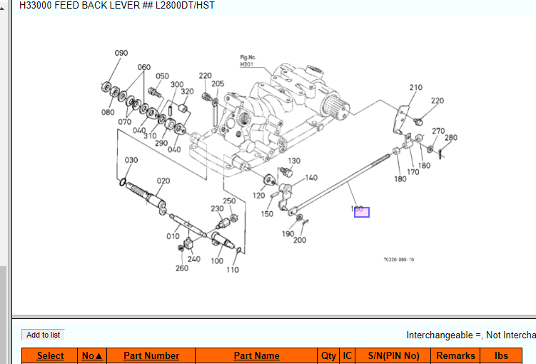

Check if symptoms the same when box blade lowered. I want to rule out any issues with the 3 pt hitch feedback linkage.
There is a small link connected to one of the upper 3 pt lift arms. Its purpose is to kick off the flow to the 3 pt lift cylinder when it reaches the end of its stroke.

To be clear, you need to locate the feedback linkage and make certain it is not compromised.
Missing or damaged feedback stuff wont affect any lowering. What it will do is bleed off hydraulic flow thus impairing loader and 3 pt functions.

Thanks so much for the info Dave. Will try to locate and check it today. Any tips on where it is on the tractor?? Mechanics are not my strongest ability but can figure most things out.

I checked the linkage and it is fine. Loader will barely move and when I just drove it, the steering is getting jumpy as well. Noise coming from what I assume is the pump. Looks like it may be going to the shop😞
