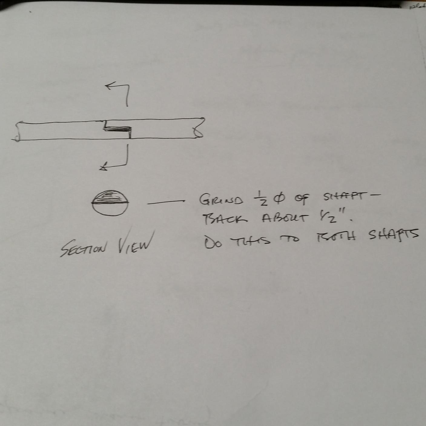

If you cut a shaft in two, here's a method to weld it. But this requires additional length of material to provide for the offset weld, but it gives a lot more strength then a straight cut that's welded back together. In your situation removing the flange and re-welding would probably be a better solution.
