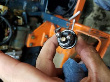

Well yesterday i got my l2550 gst in the shop started pulling things to get closer to splitting today dropped the oil out of transmission case and the front drain plug magnet had a few metal shavings not bad but there was 2 balls from a bearing. So maybe i have bigger issues than a clutch back plug was clean not any shavings really to speak of
28,610
5,070
Post a picture of the ball bearings, it could be that they are the detent balls from the rotary shifter, did you pull the E-clip off of the shifter assembly ?
If they are you will need to pull the side cover.

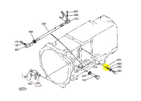

The PTO shifter detent ball.

Tonight I investigated the rotary valve and pto detent ball. Rotary valve didnt have any balls I assume they go on top of the springs. Pto detent ball was there I do need to get the correct wsm used to have one but its disappeared.
28,610
5,070
So that explains the ball bearings, I thought they were the rotary valve detent check balls. ;)
