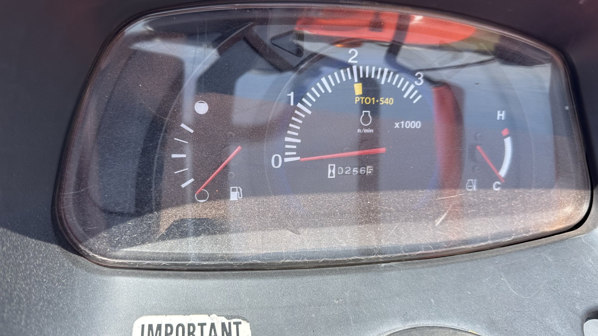

2018 4WD (unsure if it’s HST yet) 256 hours, bucket and brush hog $17,000. It’s probably spent a fair amount of its life

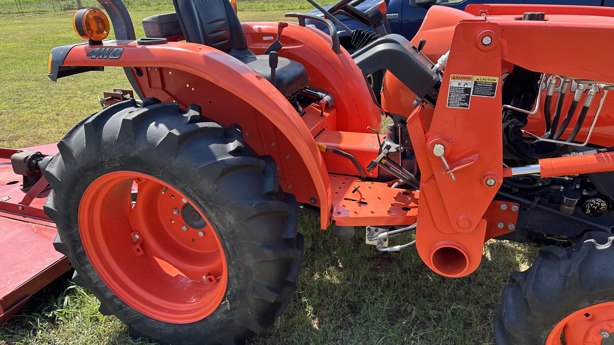

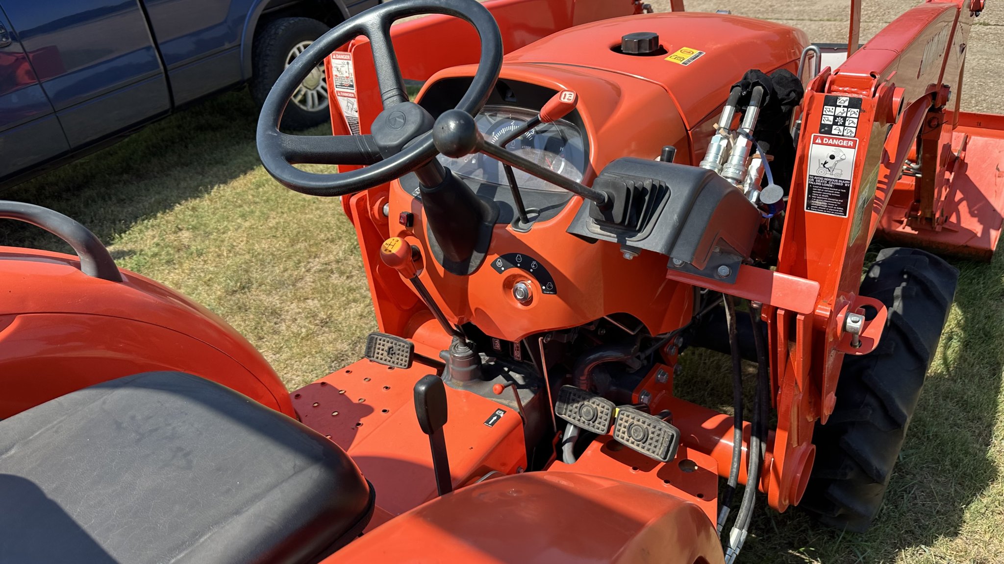

FYI, looks to be the gear drive. Orange handled lever coming up from center floor toward front of foot platform.
The loader is not optioned with a skid steer quick attach which is a negative. If your needs will include a grapple or pallet forks besides the bucket you will end up converting to the SSQA or move on to a tractor that is already equipped.
Tilling the 30 x 30 garden once or twice a year is not an issue.
30 acres 5 times a year is a lot of brush cutting. Most of the L2501 package deals and owners equipped with a 5 foot cutter. I have experience with my HST L2501 and 6 foot light duty Landpride brush cutter and cut trails, native seeding areas and it does a good job. That being said with the amount of acreage and frequency you mentioned I think I would be looking for a larger tractor able to pull a wider cutter, even a small bat wing.
17K with 256 hours with unknown brush cutter seems inline , just not sure it is the tractor you want for the 30 acres of cutting.

I'm not 100% sure, but I also agree that the one you pictured is probably a "gear drive" due to that orange handled stick pictured.

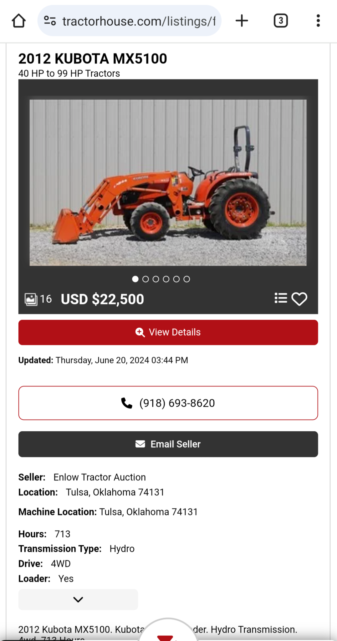

Considering your usage in heavy brush, the MX would be a far more powerful and stable platform for you.

IMO, I’d sort of think about how much time you have or plan to spend mowing, and try to figure out the size of implement needed and size the machine to that.
I have an MX, and I love my MX. I am not sure what cutter you plan to use, but my rough estimate for Mx with a 6’ cutter mowing pasture (less than 1’ tall grass) is about 30ish - 45 min / acre…that’s in M range…if what you are mowing is rough M would bounce you a bit. In L range when I have mowed in grass more than a foot tall (say closer to 2-3’) it’s closer to 1 acre / hour….it sort depends what mowing around how many turns making etc. might be a little faster depending on your terrain and cutting path. If truly brush hogging and clearing it’s going to take longer than that IMO without a larger cutter and machine.
I guess what I am getting at goes back to some of the first posts in the thread regarding time to mow. Height of grass and density and terrain are going to have a lot to say about how fast you can mow. My estimates are only good for my pasture. (It’s just open field / grass).
I sort of think you may need to think about different chores…first one being based off your description is to reclaim some areas and get it to where you can mow it. Depending on how dense the brush and cedars are and what’s in the field you can’t see, might consider to rent or hire some one with a CTL / mulching head to get it cleared off first. Save some wear and tear on your machine, and then maintain with what you think appropriate for the size.
I think an MX would be just fine (if the time to mow estimates match your expectations), but if you are wanting a batwing type mower I am not really sure what size machine is needed. Then again if considering a cutter that large id check in with members running a batwing or mowing that size of property. I think you could easily spend the better share of a day mowing each time…or break it up and do section per time out. Either way 20plus acres takes some time.
MX is a great size machine and would be an appropriate size to consider…I think an M would be as well. I think pending size of your implements might suggest one over the other.
