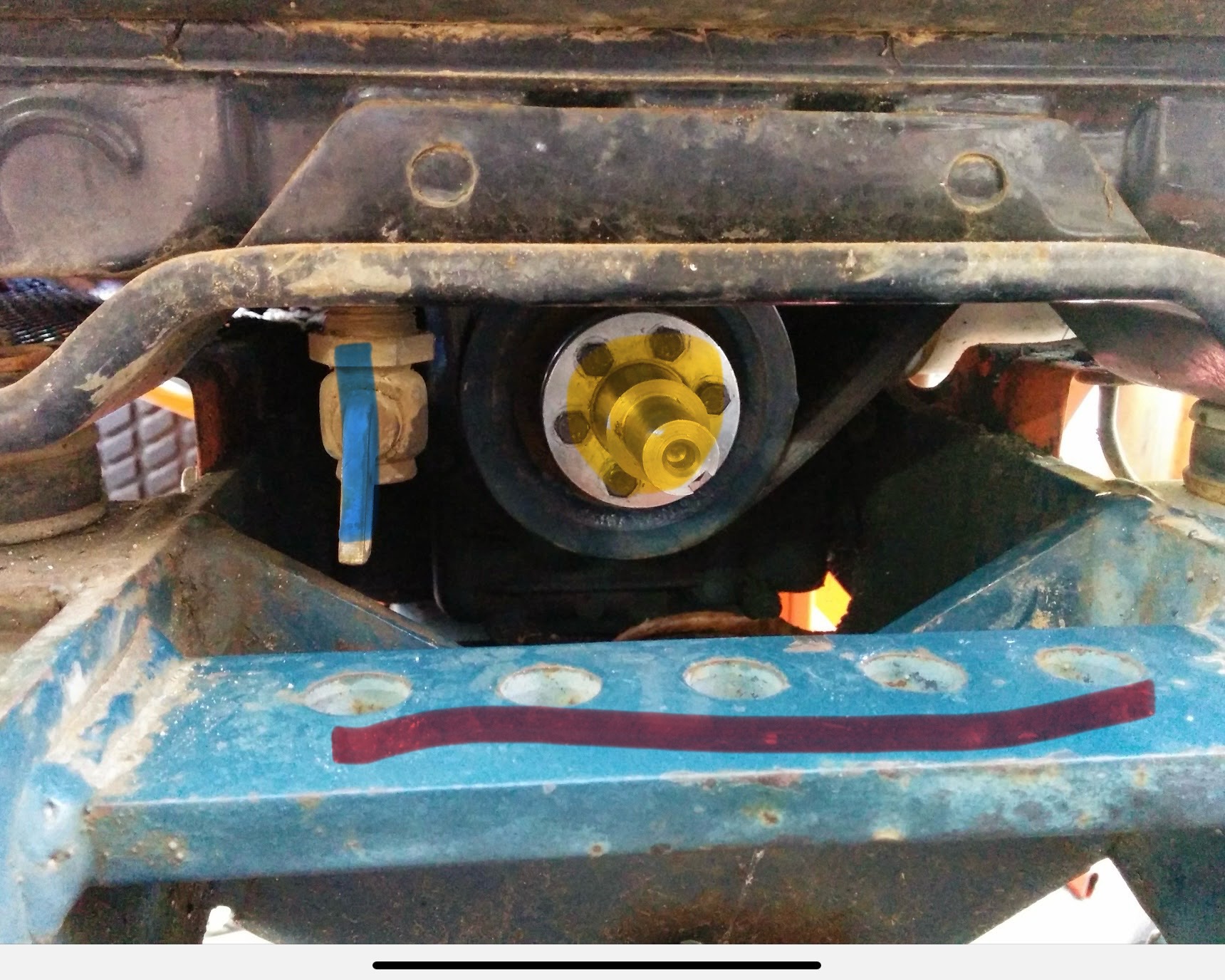

Would you happen to have any pics of that said shaft for the hydraulics
See this thread post #32 for a picture of the engine crank shaft that comes out of the front of the engine.
This is a picture, from the front of the tractor, that shows how that shaft was used to mount another shaft that then was used to drive the hydraulic pump. The yellow is the shaft. The red is the weight bracket. The blue is a radiator drain.

I saw the pictures you posted above but have no idea what you are trying to show or where that is on your tractor. Please back up some or describe what you are showing.

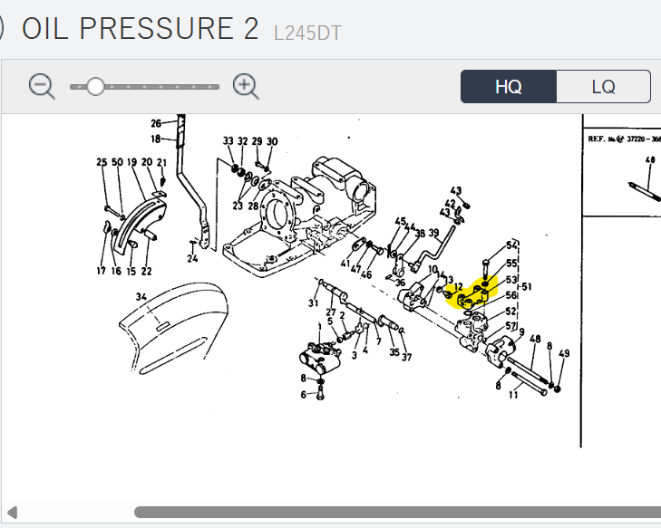

Would anyone know where or how to hook up the separate pump for the FEL on a L245 DT ? Currently I have a double sprocket with a shaft running to the pulley with a piece of rubber in between ( not my design) bought the tractor set up like this and it has failed me. is there a different set up?
Is this diagram your setup? Item 10 is a flexible coupling. The part is discontinued so we can't see how it's made, but perhaps the flex is provided by a rubber element? The crankshaft nose is splined and the pump also, I think. Are these splined couplings what you've described as sprockets or perhaps they've been modified?
All these parts have been discontinued, so you'll need to improvise if you want to keep the front pump system.

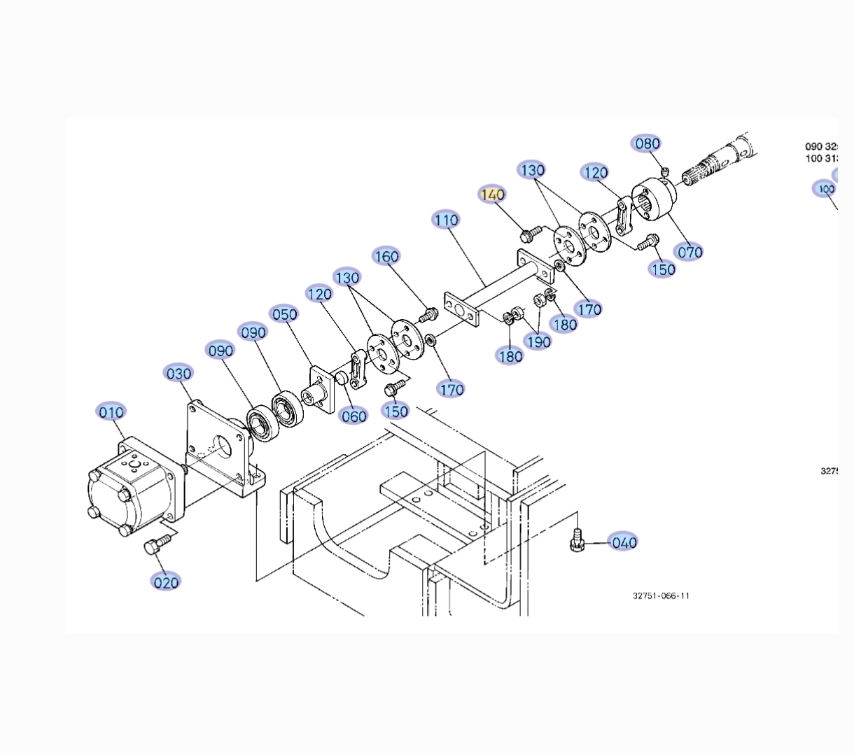

Some folks have used chain couplings and a spacer shaft. @Russell King has referenced one method. The L35 uses disk couplings with a spacer shaft as shown below.
I think the first issue is to check the condition of the splines. If they are in good shape, you could use the ends off the coupler (for the splines) you have and add gear couplings to each end.

would you happen to know where I could purchase the yellow part

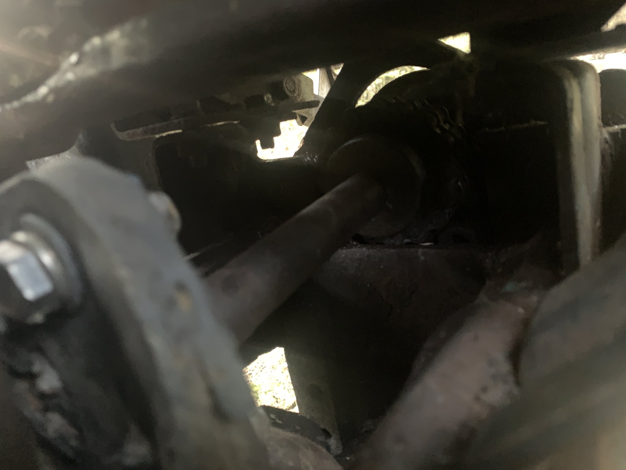

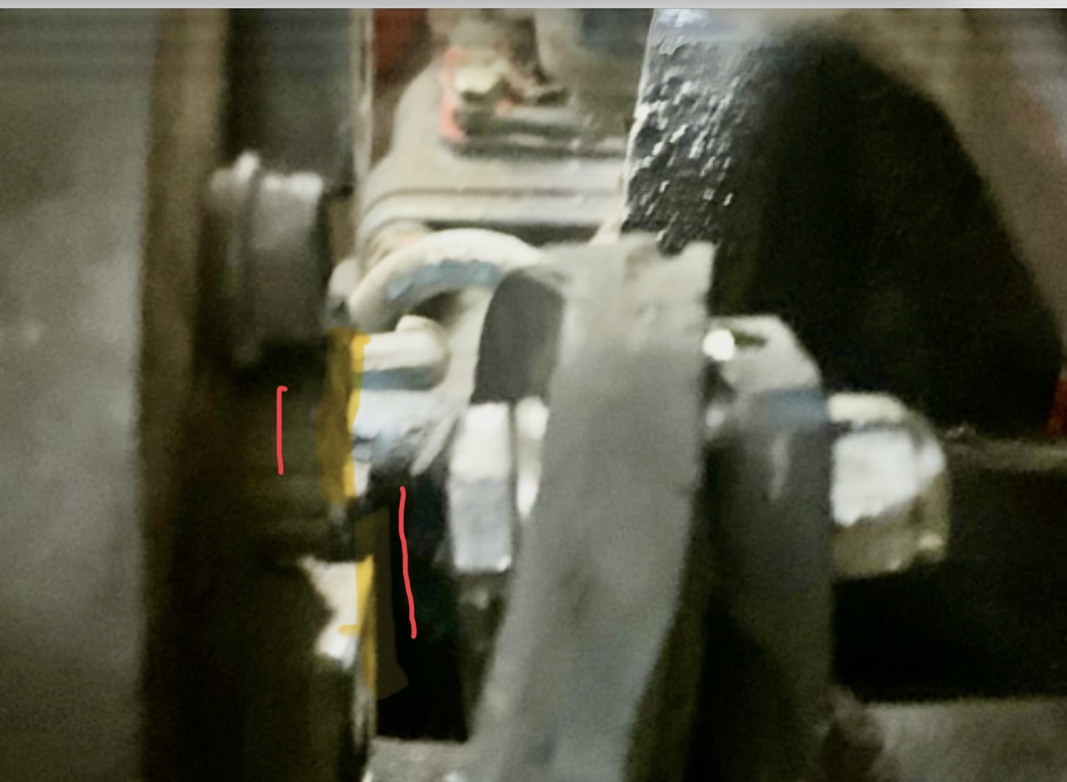

These are side pics of where the shaft hooks on to the engine and the other pic is from the pump to the dual sprocket coupling sorry they are not very good pics
It looks like it's not connected at the crankshaft, and I don't see splines on the crankshaft. Is that right?

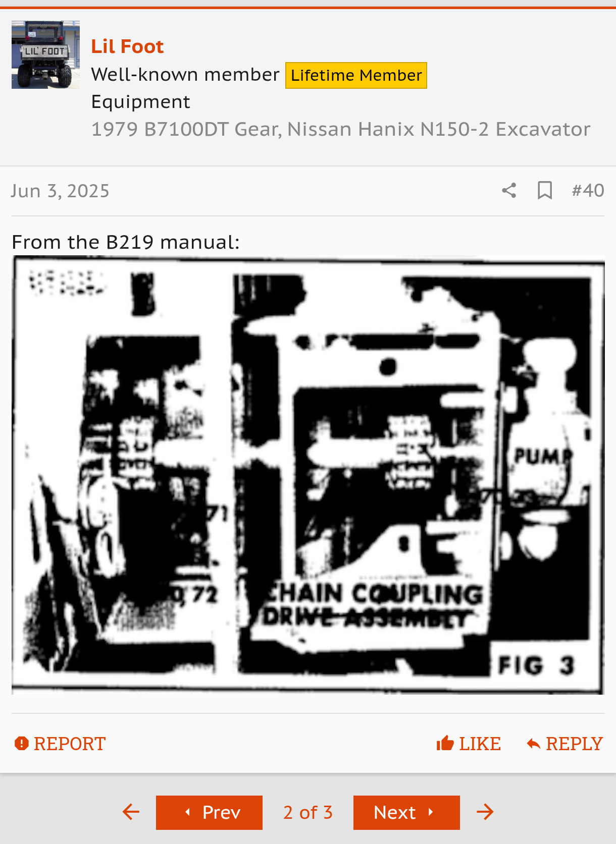

Here's a link to another front drive chain thread and an excerpt from it that might help. This is the setup I was alluding to in my earlier post.
No you can not buy parts for that system any longer as new parts. There may be some used parts somewhere in the world but I don’t think those even exist anymore.
That shaft (yellow) was a custom machined part that was clamped onto the shaft that exits the front of the engine. He used a commercially available “taper lock hub” to clamp it onto the engine shaft. I believe that he posted a link to that in the thread I linked above. There are other methods to do that and there are threads about that. If you search you sh be able to find them. If not just ask and I will try to locate them and link them here.

I took a screenshot of your picture and tried to make it more legible. I think I see the shaft out of the engine marked in red. Then it appears that the shaft is broken into two pieces. The break is highlighed in yellow on both sides. Please take a bright flashlight and shine in there and verify that is what has happened. If so you will NOT be able to easily use the front mounted pump any longer.

That is correct It is no longer connected it was connected with bolts going through rubber
I will get you a better pic this evening after work thanks

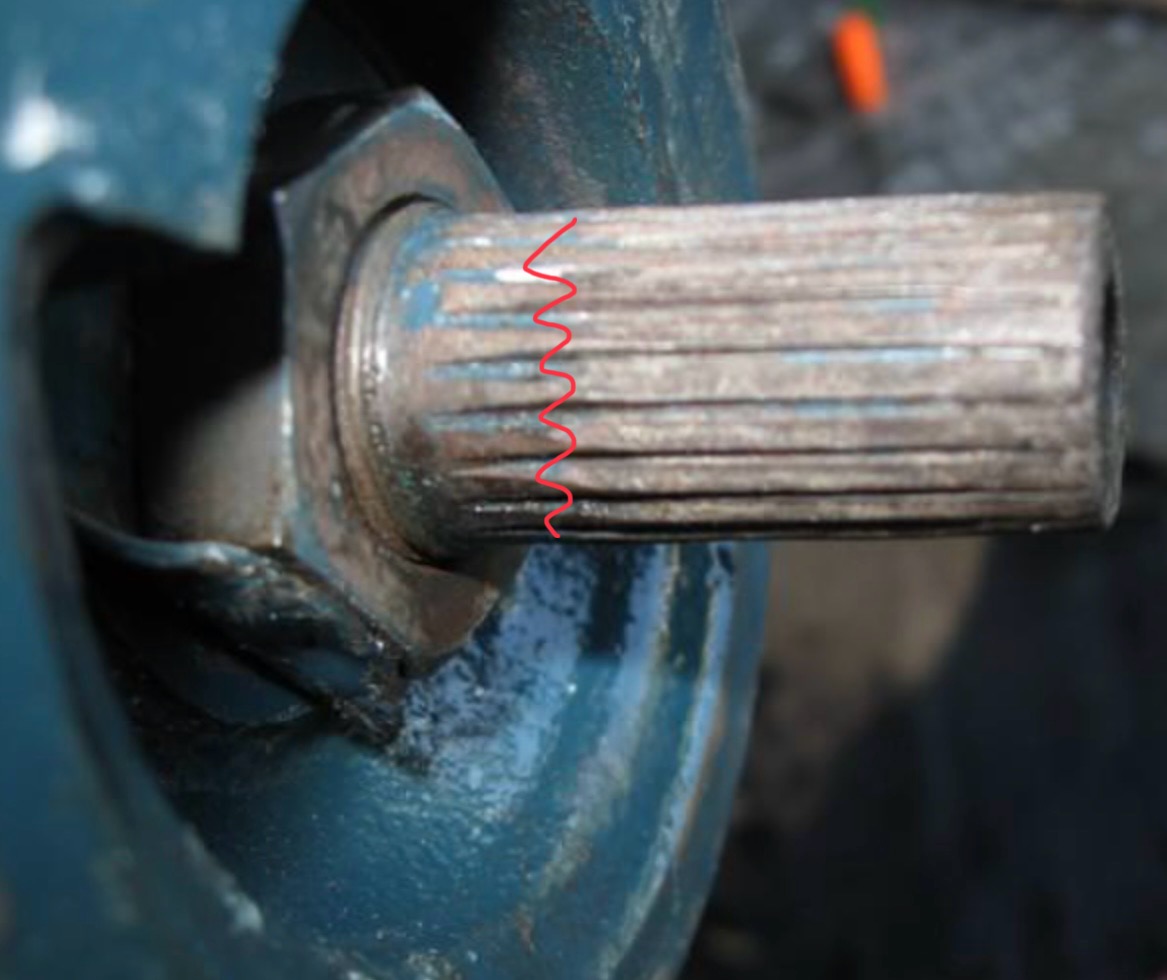

The shaft on my crankshaft is a few inches long. Probably four or five inches long and has a good chamfer on the end. Here is a picture of a similar shaft that should be there. The red mark is where I think yours is broken off. But I hope I am wrong!
