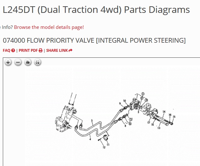

There can be PS on a L245DT contrary to tractordata.com
Messicks lists the parts including a priority flow valve which ensure the PS always has sufficient flow and pressure to operate
It there is a FEL on this tractor, then the hydraulic block can have a selector valve to switch between the FEL and the 3 pt hitch.
Previously. owners with the same problem found the lever to select between the FEL and 3 pt was partially out of position.
Dave
Dave
Oh OK. Someone will have to let Peter from TD know! Lol.
