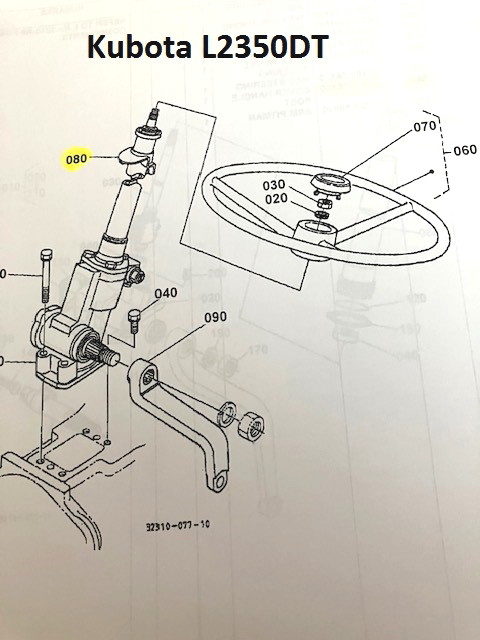

Needing to replace some seals in my steering column (oil coming up through top) but am having trouble removing the steering wheel. I assume the steering shaft is splined, but can't tell if it is tapered or not.
I have tried penetrating oil, lightly using a pickle fork underneath the steering wheel base and also a two jaw puller to no effect.
Anyone done this and can advise. Thank you in advance.

I just pulled one off a B7800 with a 3 jaw puller. Tighten the puller up and then hit it with a big hammer. Might take a few tighten and hits. Shaft ws splined.

Finally got it off using a bearing splitter underneath the base of the steering wheel and a puller. It was on there TIGHT and made a loud 'pop' when it finally gave in. Was easy to remove after that.

Wasit splined or just a Morse taper? If splined, I would put a VERY light coating of never seize grease.

Yes, Sir....splined (no taper). Will be using some antiseize going back on.
