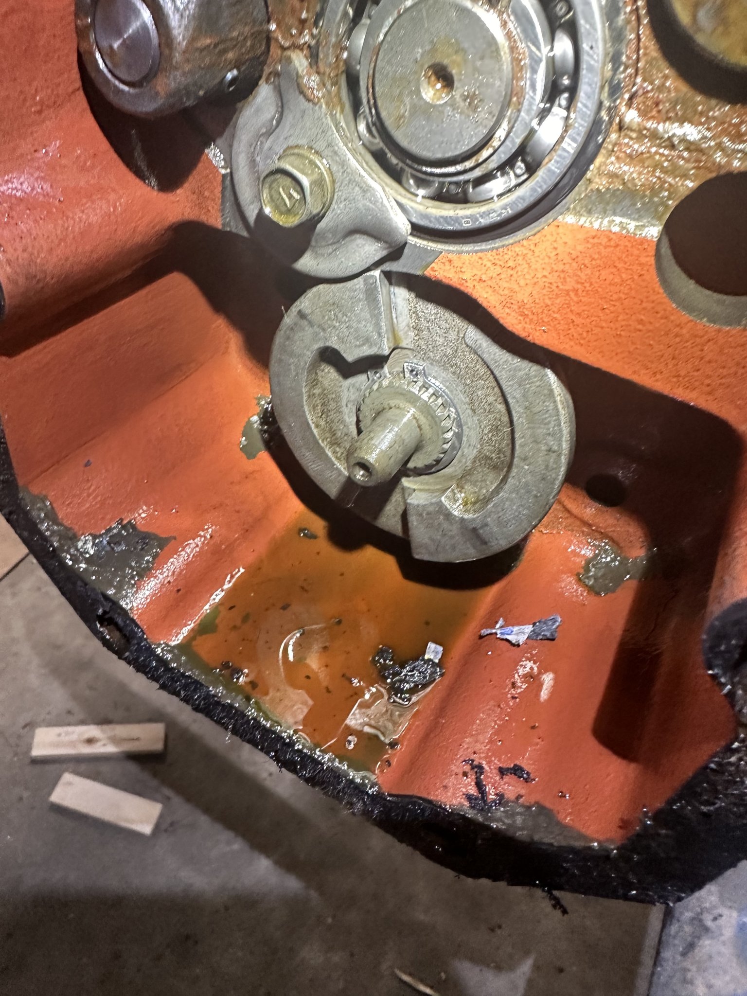

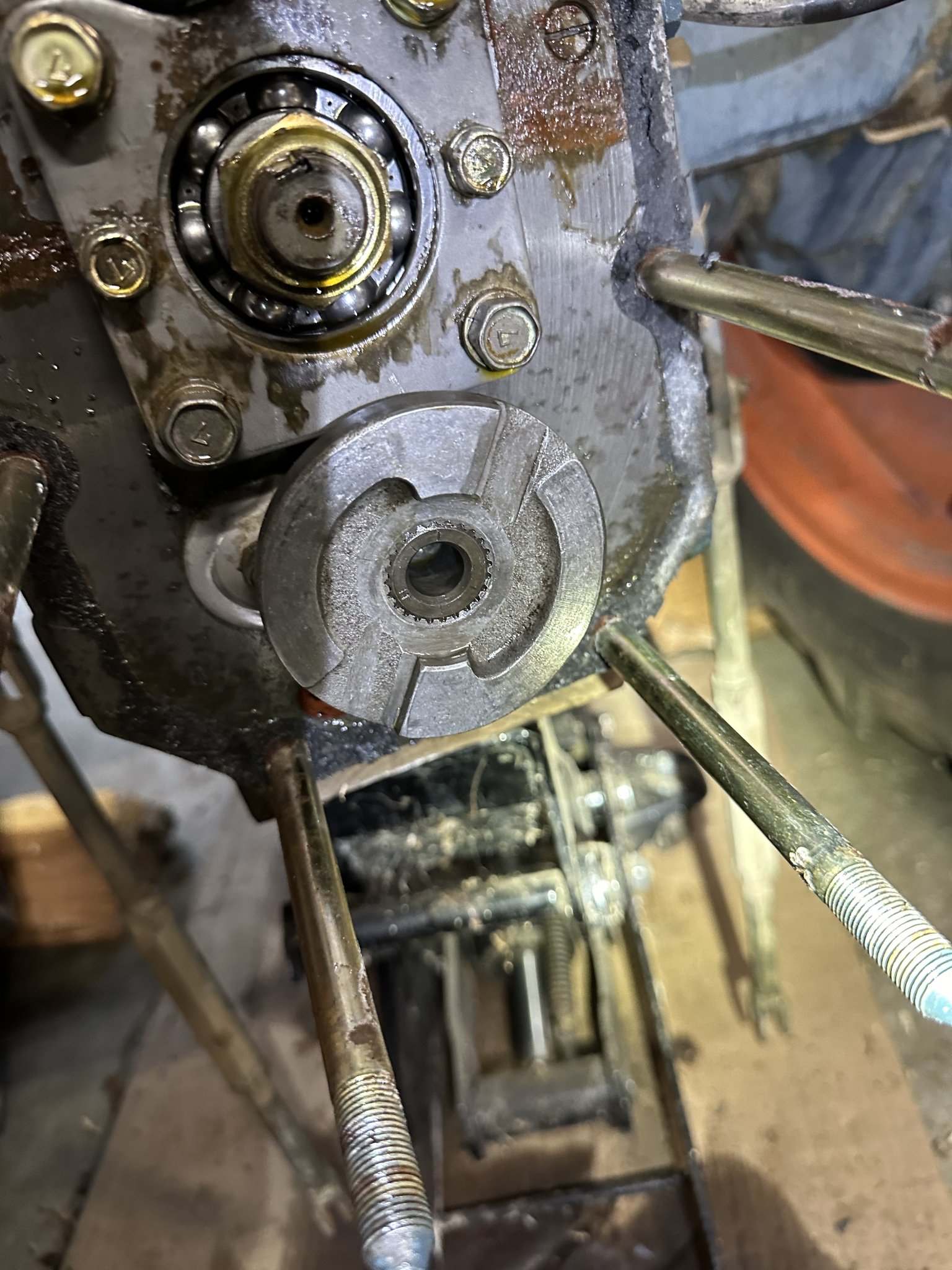

Tractor is apart! Problem is the clutch cams seem to be ok. See pics. The forward cam spring seems ok too. I can get the forward cam to rotate the forward shaft and the rear cam to rotate the rear shaft. Only thing I can figure is they spread apart somehow and aren’t making contact.

I have seen where the spring loaded half get stuck and won't engage in the other half. Also have seen where they are just wore out and won't catch.
34,145
9,332
The came look like they are in great shape.
They don't look stuck or broken.
Sounds like you have a problem before or after the cams.
If you turn the rear cam, is it connected with force (no slipping) to the rear PTO?
Can you turn the front cam with the PTO engaged?
Rear cam turns the pto output, no slipping. Front cam turns the front shaft just fine too. I can try engaging the pto and turning to see if there is resistance. I’m wondering if the spring was stuck and got unstuck during disassembly??
If you can turn the front cam with the PTO engaged, you have a problem with the gears or the shift collar in the front!
You should not be able to turn the front cam with the PTO engaged.
The spring is super easy to check (very unlikely your issue), just pull the snap ring and the cam and spring will come right off.
cam won’t turn when pto is engaged. However while playing around with the cam on the spring I can get it to stick when the spring is depressed. I think this is my issue. I’ll pull the cam to inspect the back of it.

Pulled front cam and spring. All is good except that I can get it to stick. I’m thinking of just replacing the spring in case it has weakened. Other than that I can’t find anything else wrong. No metal shavings anywhere indicative of excessive wear. Only other option I see is putting it back together and testing.
