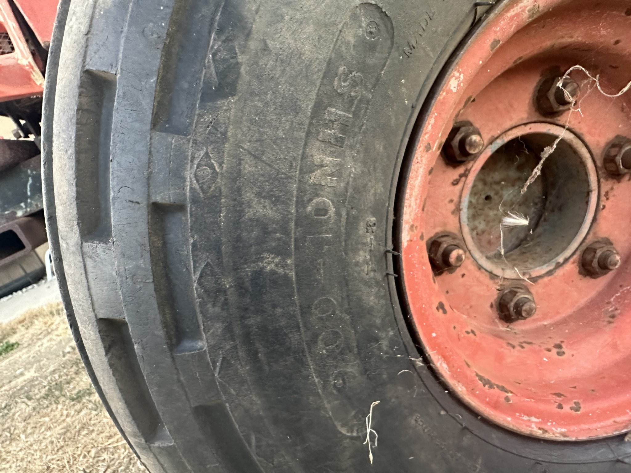

Different engine on your L2250. Your tractor is the direct predecessor to my L2350.
What’s odd though is online it lists a spin on for my engine
also when I checked it out mine ONLY had the filter and the spacer. In this parts diagram. Don’t know how important the other two missing parts are here circled in red

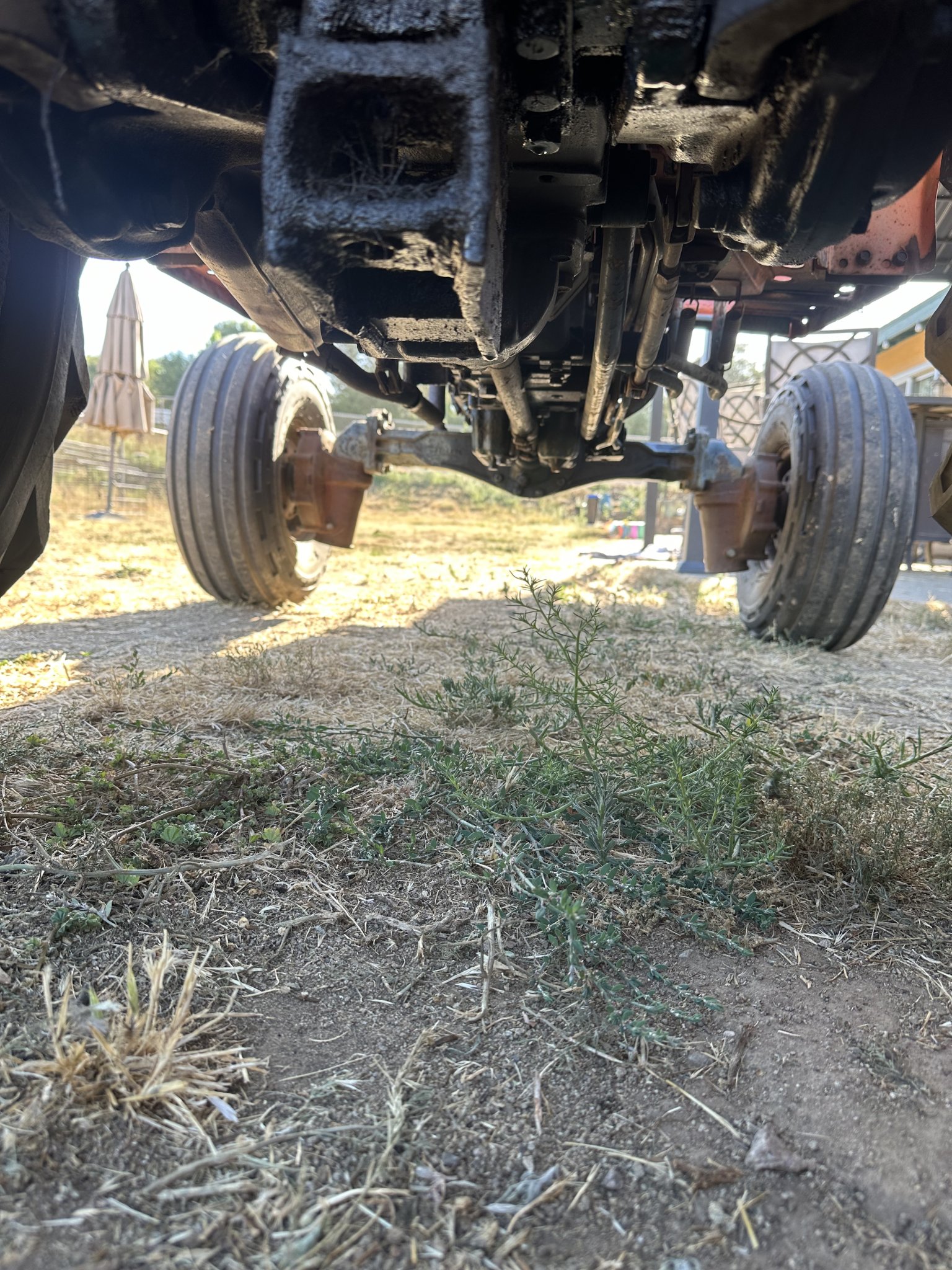

it also has a pretty good hydraulic leak around the rear axle. Not sure if it’s worth chasing it down. IMG_6236.jpeg IMG_6235.jpeg

I suggest that you clean the underside of the tractor with a pressure washer to get all that grime off, and that will give you a better idea of what is leaking and how bad the leak is. It will also lessen the chance that your tractor will go up in smoke. I learned early in life that if you have to wrench on something you want it to be clean so you can clearly see what you are doing and you will not be contaminating the inside when you remove a part. Think of yourself as the surgeon and the tractor is your patient that you are operating on. No room for excuses or mistakes.
Anthony250f
Jun 4, 2023
20
San Diego
This is after about 30 mins with a pressure washer LOL. Should have seen it before. Zero blue showing. I cleaned it up more and it’s 100% coming from the stud that goes from the transmission to the right side brake case. Unfortunately that means I have to split the cases and reseal.
The oil pan leaks a bit too.

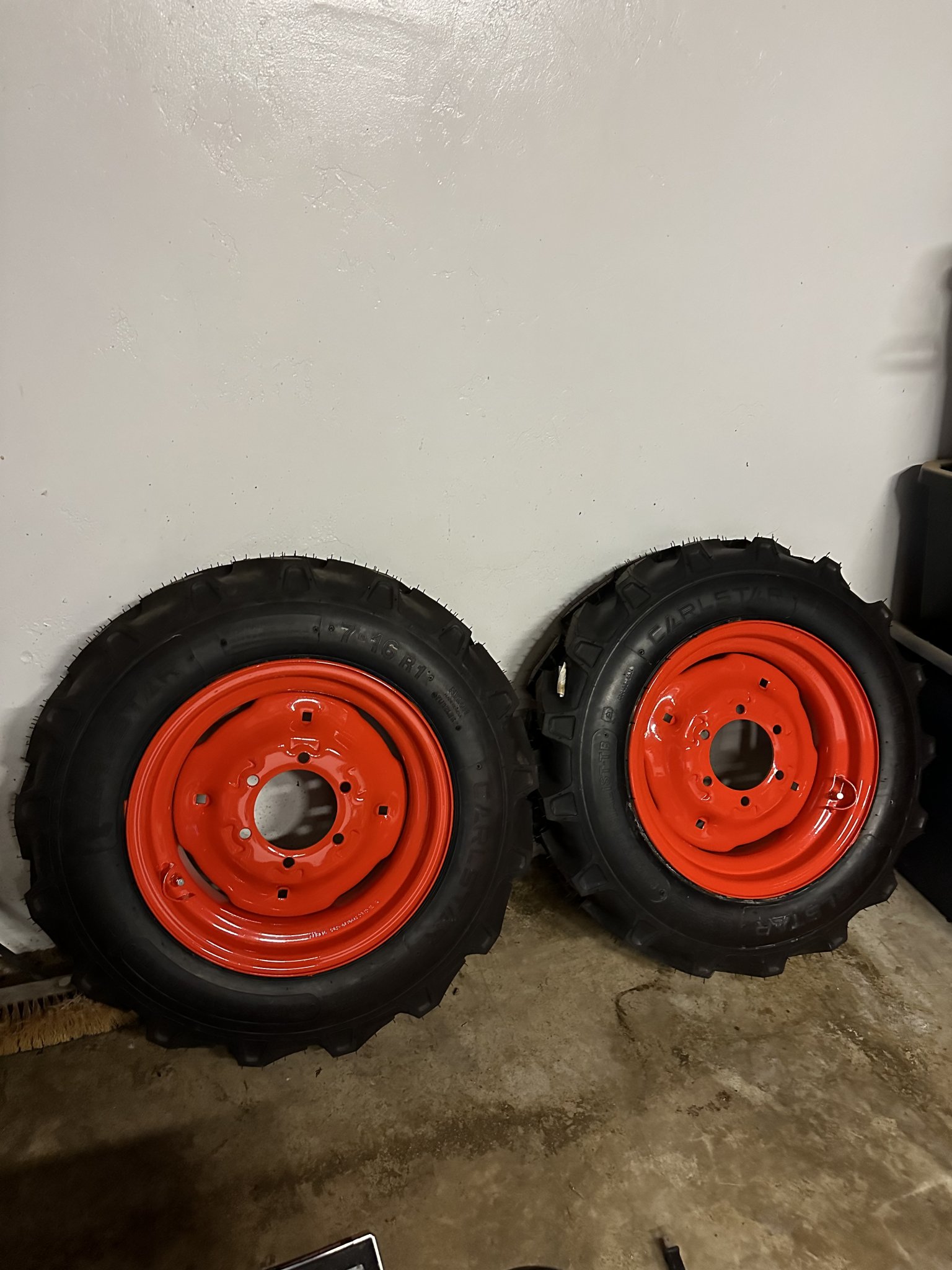

After some searching and much help from their customer service, I found these. We double checked all the measurements over the phone and they should work. 2 new wheels painted orange for less than $300 shipped.
I bought mine from quality farm supply but they looked identical minus the size
