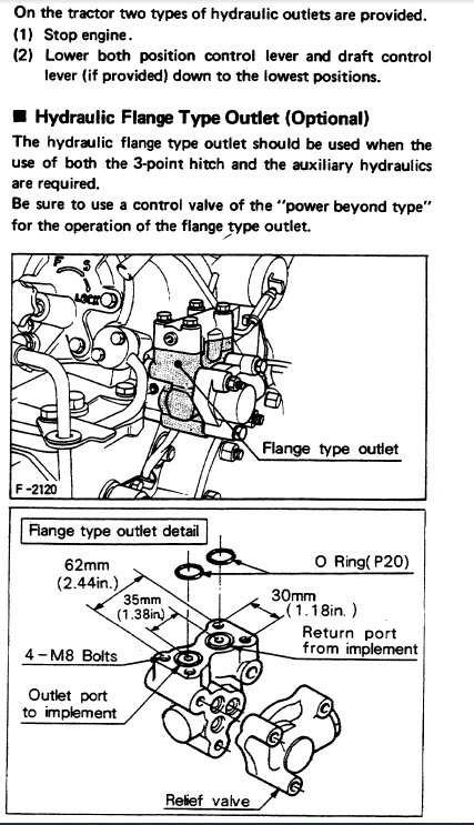

Please check your machine to determine if your loader valve is connected to a flange type outlet as shown below.
In diagnosing what is wrong we need to start with how is the loader powered by the tractor's hydraulics.
Often, during the replacement of a hose, two hoses get swapped and then nothing works properly.
