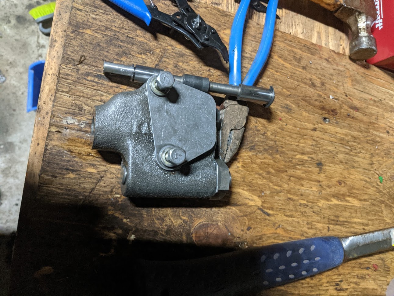

Just a wee update to close this off and document the fix for any future readers.
The problem ended up being the drop rate valve itself. Turns out the little metal bit that came out of the spool valve when I removed it was the tip of the drop rate adjustment screw.
There must have been some kind of impact at some point which snapped the tip off. See picture of the old vs new side by side.
New screw was had from Kubota for around $75 give or take.
I was able to source a replacement valve, piston and sleeve online (all used) by Googling part numbers periodically. One thing that helped was making sure I added a dash after the first five digits in the part number. Googlefu
Never did install the new piston or liner since mine actually looked better. Just polished them up a bit.
Put everything back together with new o rings, backup rings etc and she came back to life!
This site was a huge help in figuring this out. Hope this helps someone in the future.
