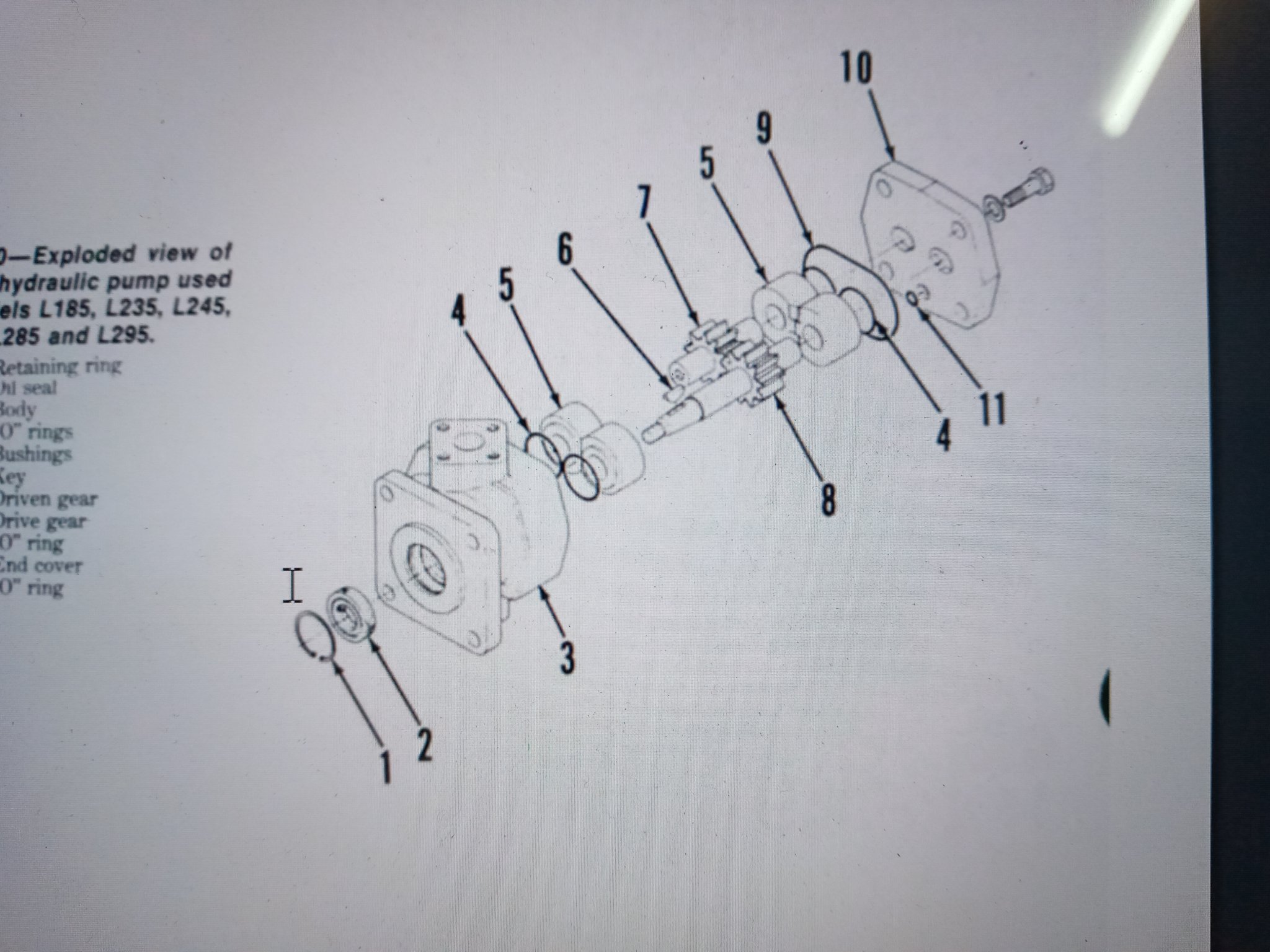

Hydraulic pump is scored around the outside of the gears and **should** be replaced if I can afford it. I was hoping it would still be able to pump enough oil to lift my mower deck for now. Pomp is moving oil, but I have no lifting power with any weight on the arms. When locking the flow control valve under the seat while the arms are in the up-position, it will hold it in the raised position overnight without sagging. there is definitely still air in the system that needs to be bled out. I will figure out where and report back later this week. Seems like a new pump would need to be purchased at this stage.

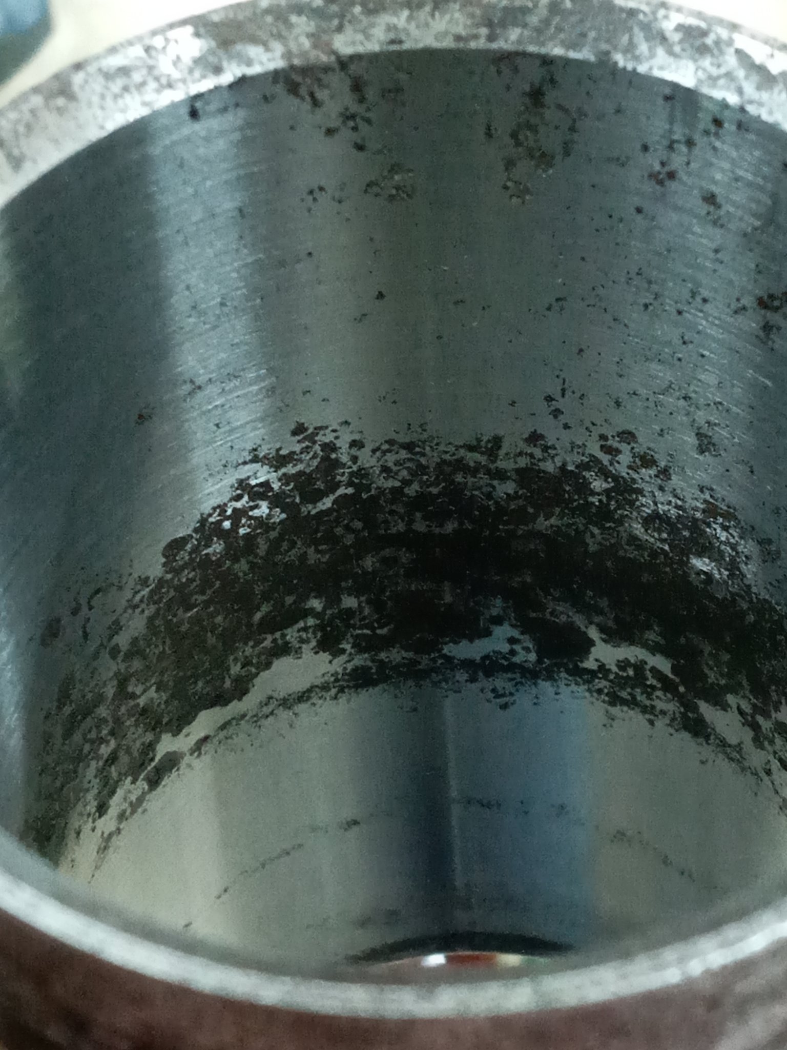

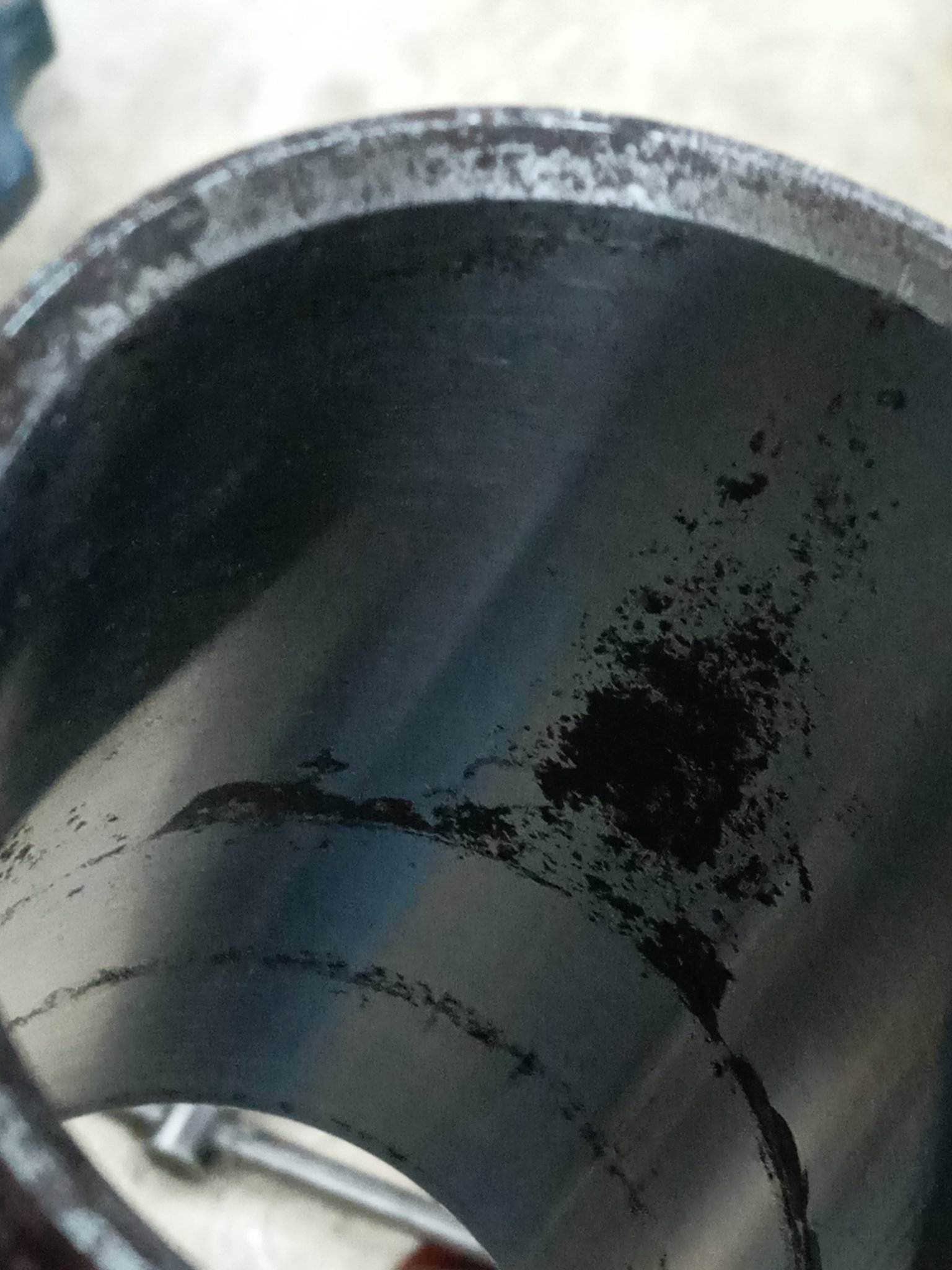

I managed to work on the tractor a little tonight.
Removed the pump again and replaced seals #4 and #11 with new. also installed #9 that was not there when I first opened the pump.
Then went to work on the cylinder and cylinder liner of the 3-point lift. Liner is badly pitted even after 30 minutes of honing. I think there is little chance that I would be able to remove all the pit marks and still have a useable liner. I would have to find a new one or turn one up myself.
I re-assembled the lot and did a quick test.
The tractor was now able to lift the mower deck, but only at fairly high revs. (confirming that the losses due to wear on pump is only overcome at the upper limits of operation.)
The deck would also only lift to a point, and stop as soon as it reaches the pitting in the bore and total losses are bigger that what the pump can deliver.
It does at least seem like the pump stopped sucking air after replacing the o-rings.
Unfortunately I think this is as far as I will get without spending money on a new pump and cylinder.
