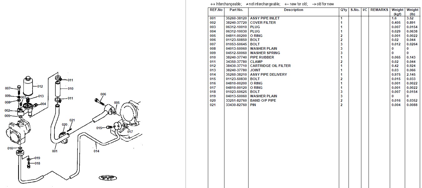

I am not familier with the L1802DT (US L235), but here is the hydraulic piping breakdown.
Also a link to some manuals.

Thank you so much!
The strainer/screen does not appear on this drawing... Strange... I thought there always was a strainer/screen.
It's the mechanism mounted to the top 0f the pump. At some point Kubota abandoned the tank strainer in the rear housing

Thank you guys for all your replies. I checked on the WSM for L235 which seems to be very similar to my L1802Dt and there is no screen for this model. Only a filter. I just ordered one as well as the Kubota Super UDT oil and I will do the maintenance in the few days.
