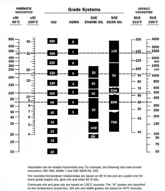

Here's a conversion chart to give you some idea how the various oil weights compare to each other. SAE 80 Gear is similar to SAE 20 motor oil with respect to viscosity.

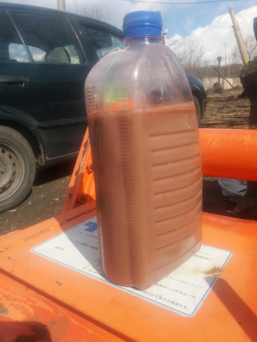

i went to get some oil to refill to the designated level on the glass scale on the LH position of the gearbox ( i phoned the dealer from whom i got the tractor to ask what kind of oil i need before that) and at the market place they said to bring a litle bit of the old oil just in case so that they can see what type is it. And form here on things got F-ed up =)) i drained about a litter of the oil and it should have been yellow as the dealer suggested, but it was not xD it wasn't red either (the yellow being LVX Austromatic 10w30 and the red ATF oil). Even worse it was cloudy and more orange than yellow and at the same time too light to be red as the ATF whitch is dark read from what i can tell xD
The oil goes that way when it has water in it, but everything is sealed as it has to be so there's no way in. i have a picture of it but :/ 2-nd post cant upload still hahaha maybe after a few post ^_^

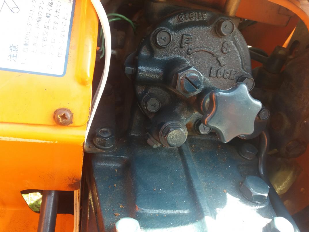

Also is this in the picture the vent???

No, that is the 3PH rate of lowering control. The vent is farther back on the case and usually has a short rubber hose attached.

That looks more like a fruit smoothie than hydraulic fluid....:eek:
