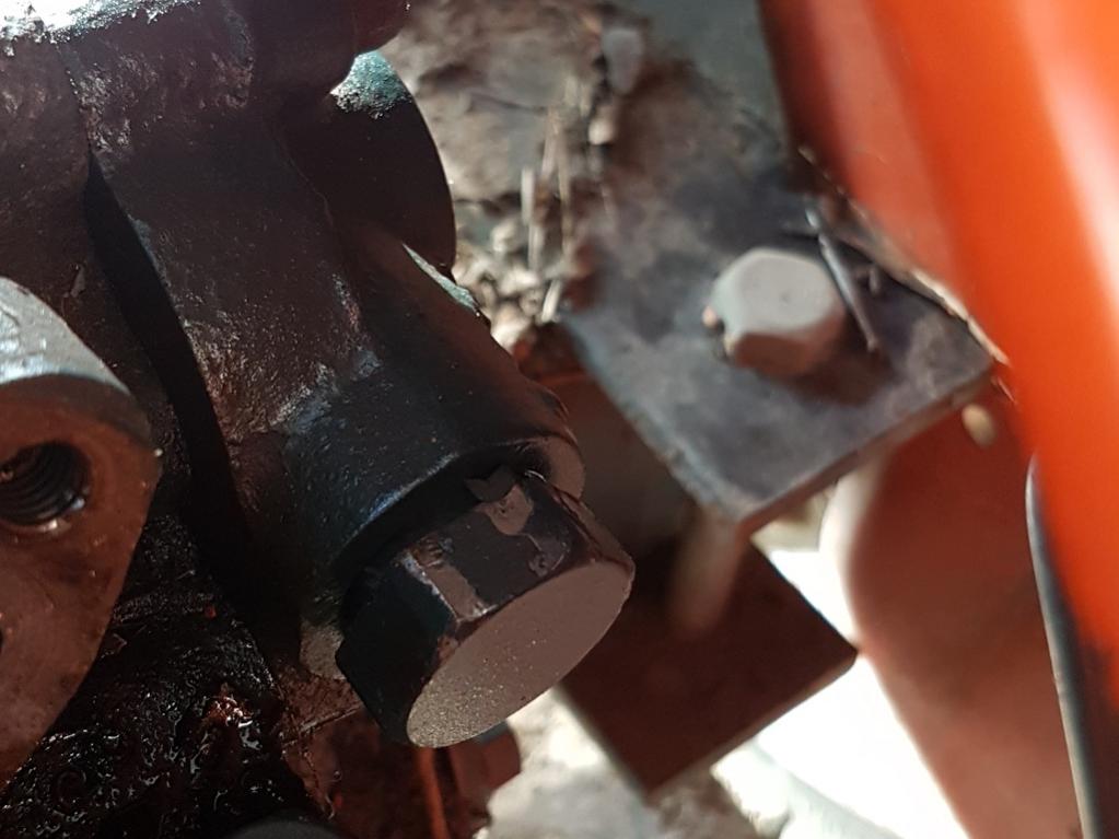

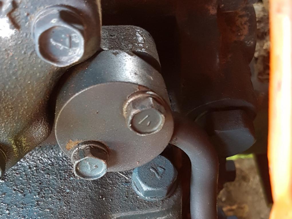

I finally found the pressure relief valve. It's on the left side of the hydraulic housing, just behind the supply connection. Mine is an L1802DT, but the 2WD version is probably similar.

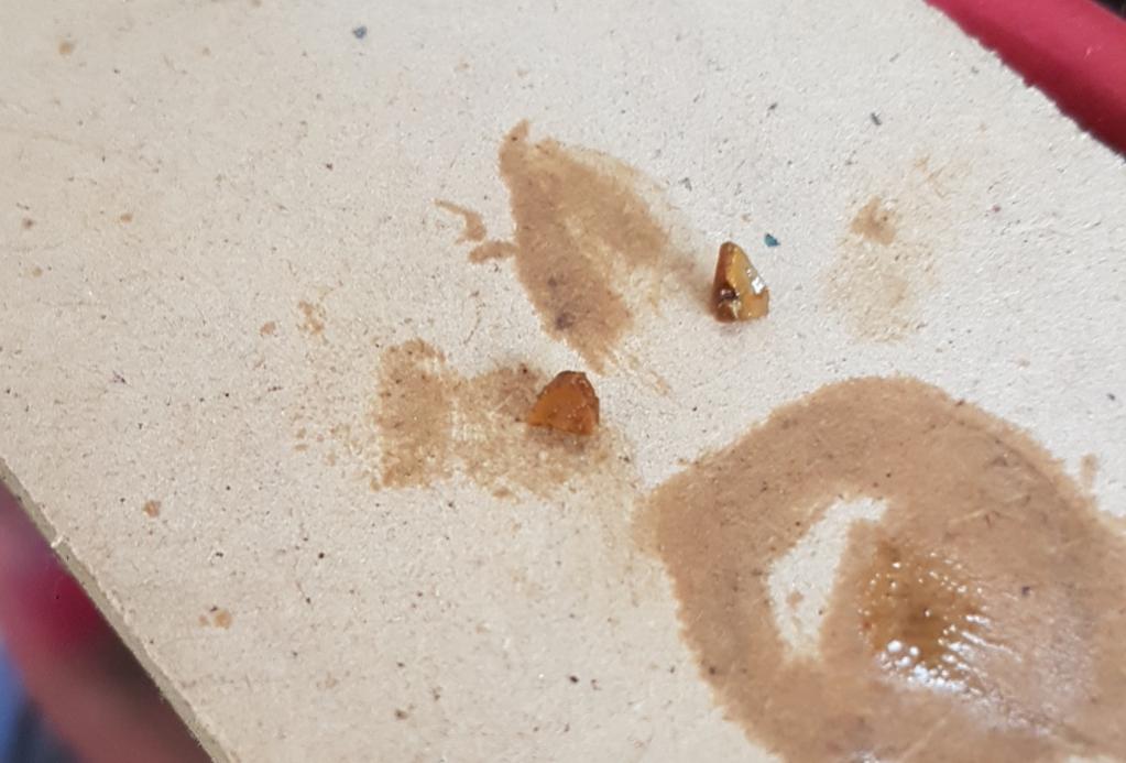

Getting the relief valve out was a bit tricky with it on the tractor, so I pulled the whole housing. Inside I found a couple of small pieces of what at first looked like gravel.
They are actually pieces of something made of a soft plastic or something. I don't know where they are from.
Anyway, cleaned the relief valve up and put it back, hoping I might have found the culprit.

The material from the Pressure relief, looks like the backup ring on the three point cylinder, Have you rebuilt the cylinder yet?

No, haven't rebuilt the cylinder. The system holds pressure, so I'm pretty sure there are no leaks in the valves or the cylinder.
